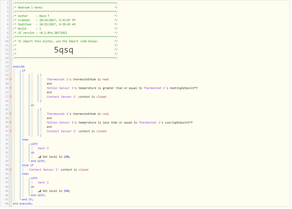

I’m trying to recreate a CoRE piston that compared my room temp sensor value to the thermostat heating setpoint with an offset of -1 deg F.
The piston will close the Keen vent in the room to 20% if the temp is 1 deg F below the heating setpoint.
I’m not sure how to add the offset value to the line of code since it was included in the original CoRE.
Thanks!
