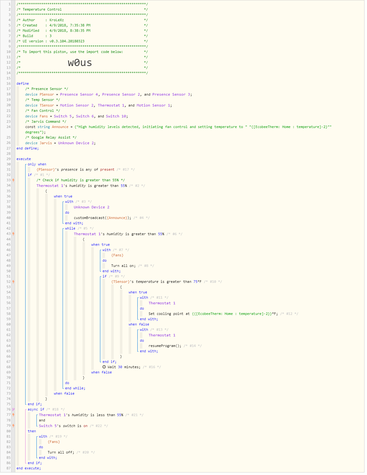

Term and Fan Control with broadcast setting - continues to repeat
Continues to fire off causing broadcast to spam and flooding thermostat with commands. I’m not sure how to use TCP or maybe it’s piston state, could use the help.
Humidity level > 55, turn on fans and set coolpoint temp to 2 degree lower than current home temp. If humidity drops below 55 than turn off fans async, I still want the AC to run a full duration of 30 minutes to avoid it turning on and off repeatedly.
