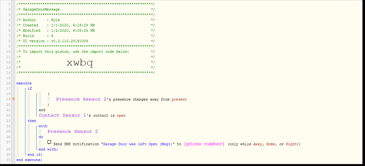

Text me if I leave house and garage door is left open - Phone's presence changes away from present not working
The text message isn’t sent because it appears the phone’s presence does not change away from present. (but in reality, it does)
“Comparison (enum) not present changes_away_from (string) present = false (1ms)”
Or maybe it’s another issue. That’s why I’m here asking people smarter than me.
Sometimes my garage door will start closing, then hit a snag/resistance, or a leaf will blow infront of the sensor and then reopen. So I have to sit in my driveway and wait for it to fully close. I’d like to just hit the button and start driving away. If the garage door has the error and re-opens (and thus would be “open”) when I leave my neighborhood, then I want a text message that it’s open so I can turn around while still close to the house and come back to close it.
I don’t want to use a timer because I regularly leave the garage door open for hours while mowing the yard or other house-duties. And if the timer was 30, or even 10 minutes, I’d basically be at Work already.
This project is my first webcore piston, so I’ve tried a few things and discovered a few things.
  • To send a txt, you have to select the ST mode: away/home/night. I don’t mess with ST modes, so it’s basically always “night”.
  • For this type of combined if-statement, It is best to have a trigger and a condition. Which I think I’ve done. “If phone’s presence changes away from present”, and “sensor’s contact is open”.
  • There is a lightning bolt next to the line with the phone’s presence, but there is not one next to the multipurpose sensor’s condition. Maybe this has something to do with my issue?
  • I made a piston that just checks if “my phone presence changes to present” and it sends a text just fine.
  • I made a piston that just checks if the multipurpose sensor is currently open, and it sends a text just fine.
    - But when I combine those two statements, it appears that the first if-statement evaluates as false.
    - When I look at the logs, it says “Comparison (enum) not present changes_away_from (string) present = false (1ms)”. This leads me to believe that the 1st argument of the if statement is not being evaluated correctly (or as I expect it to). I left the house at 7:49am today. My presence should have changed from present to not present. That evaluation should have been true.

1/3/2020, 7:49:19 AM +972ms
+1ms ╔Received event [Kyle’s iPhone].presence = not present with a delay of 54ms
+74ms ║RunTime Analysis CS > 19ms > PS > 39ms > PE > 16ms > CE
+77ms ║Runtime (37942 bytes) successfully initialized in 39ms (v0.3.110.20191009) (74ms)
+78ms ║╔Execution stage started
+85ms ║║Comparison (enum) not present changes_away_from (string) present = false (1ms)
+86ms ║║Condition #3 evaluated false (4ms)
+87ms ║║Condition group #2 evaluated false (state did not change) (5ms)
+88ms ║║Condition group #1 evaluated false (state did not change) (7ms)
+90ms ║╚Execution stage complete. (13ms)
+91ms ╚Event processed successfully (91ms)
Try rebuilding the piston…

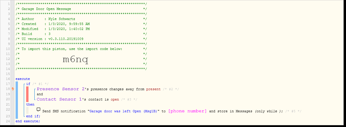

This is what the piston looks like after modifications. I’ve tested it to work.
Again, the only problem is that the samsung multisensor doesn’t always work. I’m probably going to do that Z wave garage tilt sensor linked by Pantheon if it keeps giving me headaches. I"m not too worried about the dispalyed battery %, just as long as it works.
