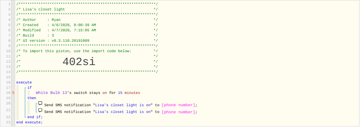

New to WebCoRE but not new to coding. Thought I’d start with an easy piston but it has me baffled. Trying to set something up that will text my wife and me if she forgets to turn off her closet light. It’s texting us even after the switch is off. I can’t figure this out and it seems so simple.
If the light stays on for 15 minutes, text us.
It’s texting us 15 minutes after the light turned on, even if it has been turned off.

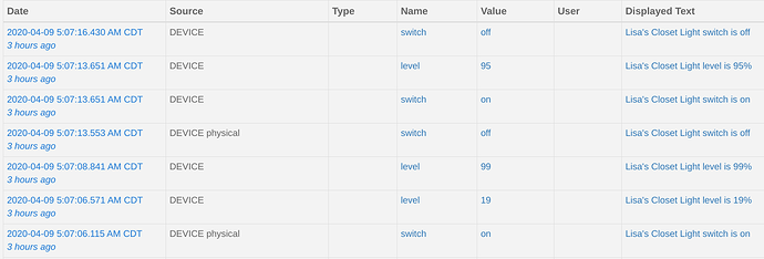

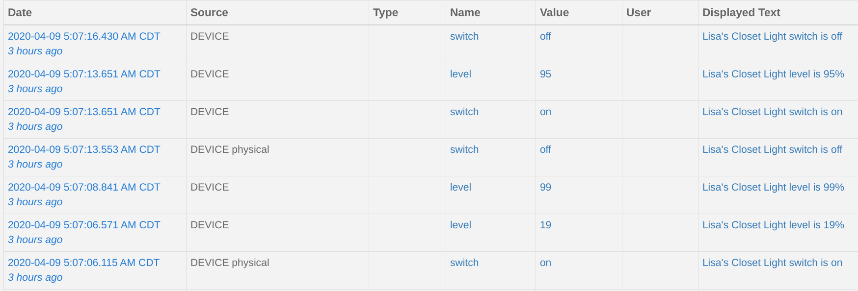

Here’s the SmartThings log for the switch this morning, showing it was turned on and almost immediately off twice at 5:07 but was clearly off at 5:22:

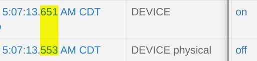

What you are seeing is the light being turned off and then being immediately switched on again, and then off again shortly after. The ‘on’ event arrives so quickly that it hits a semaphore and so arrives after the ‘off’. As the ‘off’ event has already been processed there is no event to prevent the ‘stays on’ being true and you get the SMS.
I also note that the second on/off isn’t flagged as ‘physical’ as the first on/off is.
The gap is so tiny (one tenth of a second), I would suspect that it was done by some sort of programming.

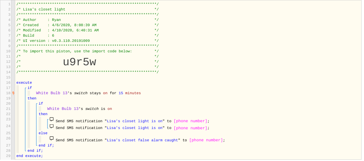

I do think I came up with the following as a solution for this. Didn’t think this was going to work but I got a couple false alarms this afternoon so it seems to be working. I could probably collapse it to one if statement but wanted to check for false alarms.
Thanks for the tip on what was going on! Definitely led me in the right direction.
