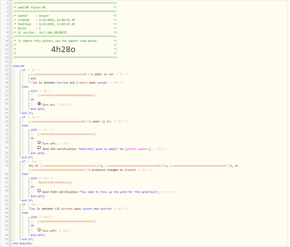

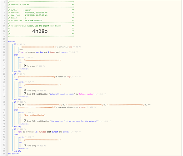

When water sensor 1 is dry and shuts off switch 18, it does not send a text out to the presence sensor devices when their status changes to home
I want to send a text to each person that arrives home when the water sensor is dry or if someone is already at home when it shuts off. So if one person arrives home and the sensor is dry but they do not fill up the pond, then when the next person arrives home it sends them a text to tell them to fill up the pond. I currently have it set up for push notifications but I would prefer a SMS message to which ever presence sensor
Just created this piston, but im sure I did it incorrectly with the $currentsystemdevice line. Not sure how to make it just send a text to whoever just came home, not everyone that is away or the person who may already be at home.

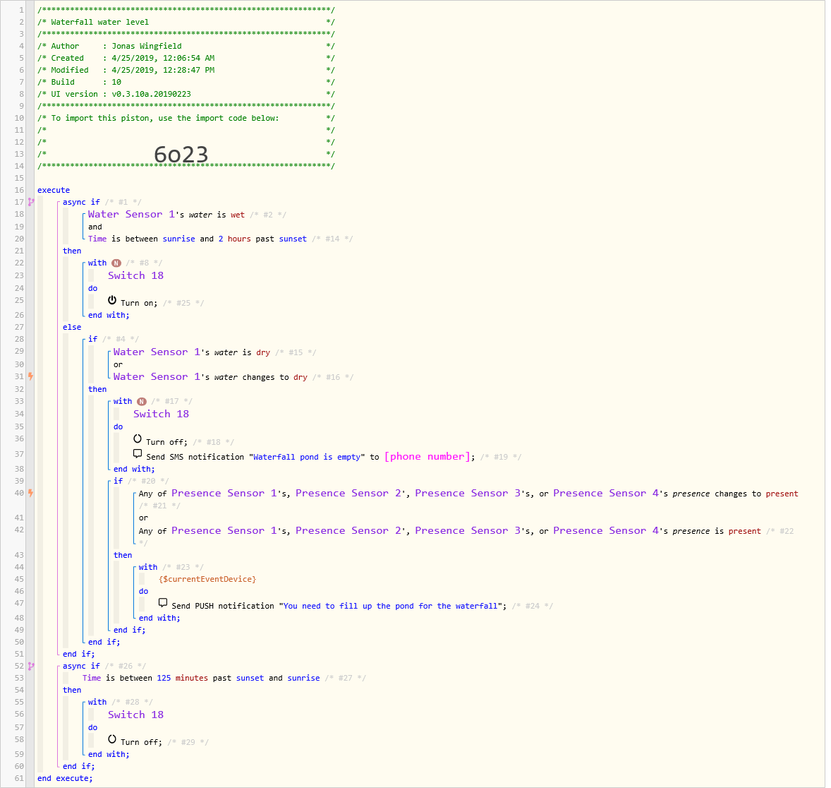

I’d structure it something like this… one thing I’d have to point out is you cannot send notification to a specific device. That feature was taken away by ST as it wasn’t officially supported.
Edit: You can selectively text people arriving but that will involve a little bit more coding.
