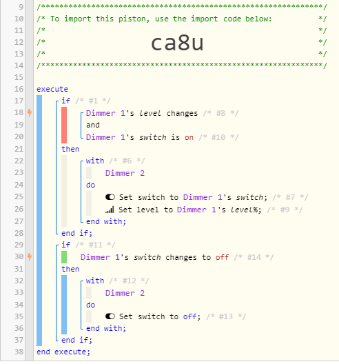

So I added the on/off logic and now I’m at this:
It’s a little slower to execute, but seems to do OK with both on/off and dimming changes except for the flickering up/down along the way. The log shows the level changes to target or ignored as it wouldn’t change anything… it’s words, not mine.
Wonder if someone can suggest better/more efficient code/logic. I’m using a trigger before the state check so it should be fairly efficient. Since the switch (a homeseer WD100+) holds both level and switch I can’t just check for 0 level and set off as I did with Vera’s “target level” to infer off vs on (anything above zero.)
Is there a better way to handle the “dynamic” live dimming than using level change trigger?
Lastly I have a very automated (i.e. lots of code) setup in vera that I’m planning to migrate over using pistons, several will interact with this piston via the device and switch, is it easier on the system if I just use the switch to control the device from those other pistons or is it preferred to “call” interaction piston-a-piston i.e. ‘inter-piston’ variables. My goal is to keep things as snappy as possible and as fool proof as I can make them, while keeping the switch and device in sync, which I expect to do by making the switch the master… I’ve tried direct association between the two but for whatever reason my forehead gets bloody and the devices are still not speaking.
Thanks for any suggestions/insights. I’ll drop the full log below. In this log I start with both off, then turn up the dimmer level of the switch, then turn on the dimmer, followed by another dimmer level change followed by off:
