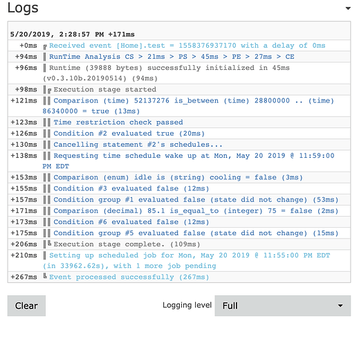

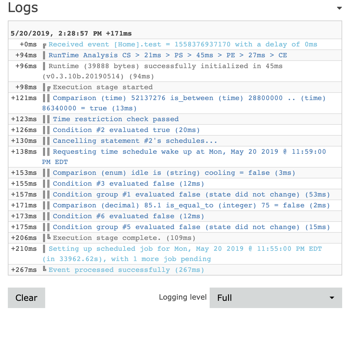

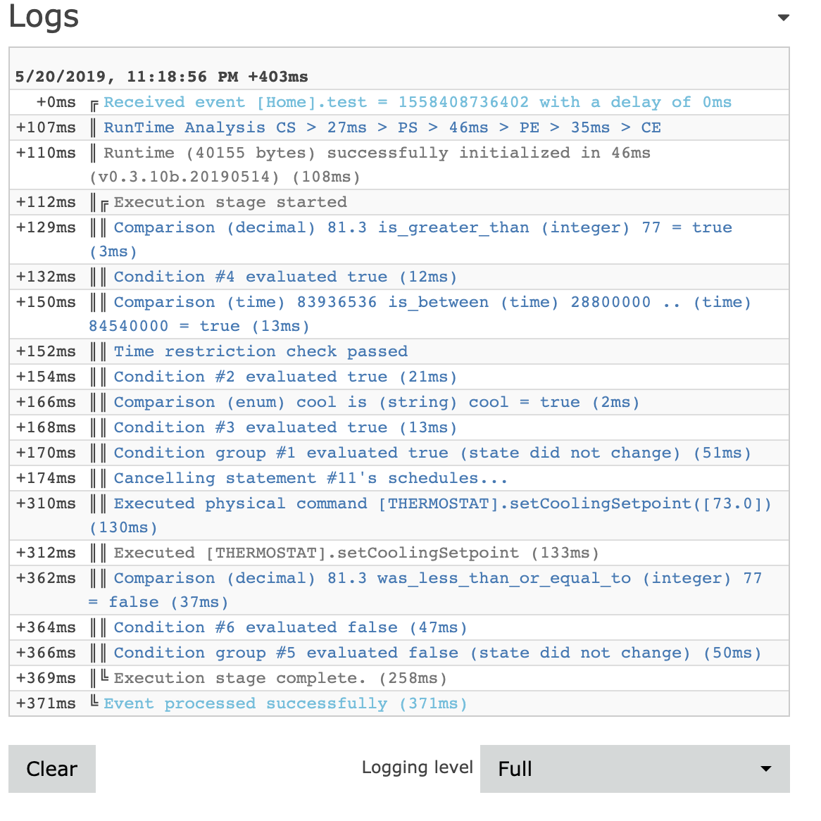

5/20/2019, 2:28:57 PM +171ms
+0ms ╔Received event [Home].test = 1558376937170 with a delay of 0ms
+94ms ║RunTime Analysis CS > 21ms > PS > 45ms > PE > 27ms > CE
+96ms ║Runtime (39888 bytes) successfully initialized in 45ms (v0.3.10b.20190514) (94ms)
+121ms ║║Comparison (time) 52137276 is_between (time) 28800000 … (time) 86340000 = true (13ms)
+123ms ║║Time restriction check passed
+126ms ║║Condition #2 evaluated true (20ms)
+130ms ║║Cancelling statement #2’s schedules…
+138ms ║║Requesting time schedule wake up at Mon, May 20 2019 @ 11:59:00 PM EDT
+153ms ║║Comparison (enum) idle is (string) cooling = false (3ms)
+155ms ║║Condition #3 evaluated false (12ms)
+157ms ║║Condition group #1 evaluated false (state did not change) (53ms)
+171ms ║║Comparison (decimal) 85.1 is_equal_to (integer) 75 = false (2ms)
+173ms ║║Condition #6 evaluated false (12ms)
+175ms ║║Condition group #5 evaluated false (state did not change) (15ms)
+206ms ║╚Execution stage complete. (109ms)
+210ms ║Setting up scheduled job for Mon, May 20 2019 @ 11:55:00 PM EDT (in 33962.62s), with 1 more job pending
+267ms ╚Event processed successfully (267ms)

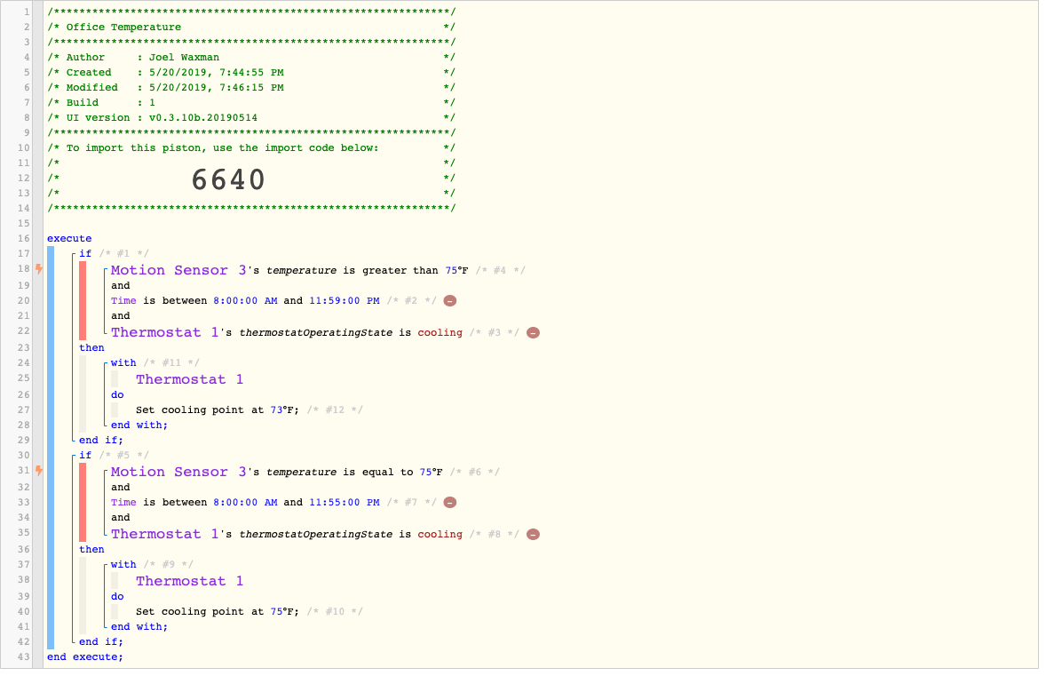

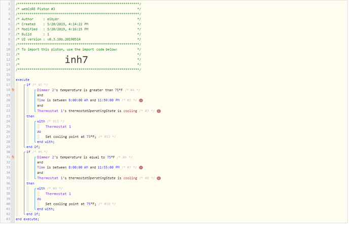

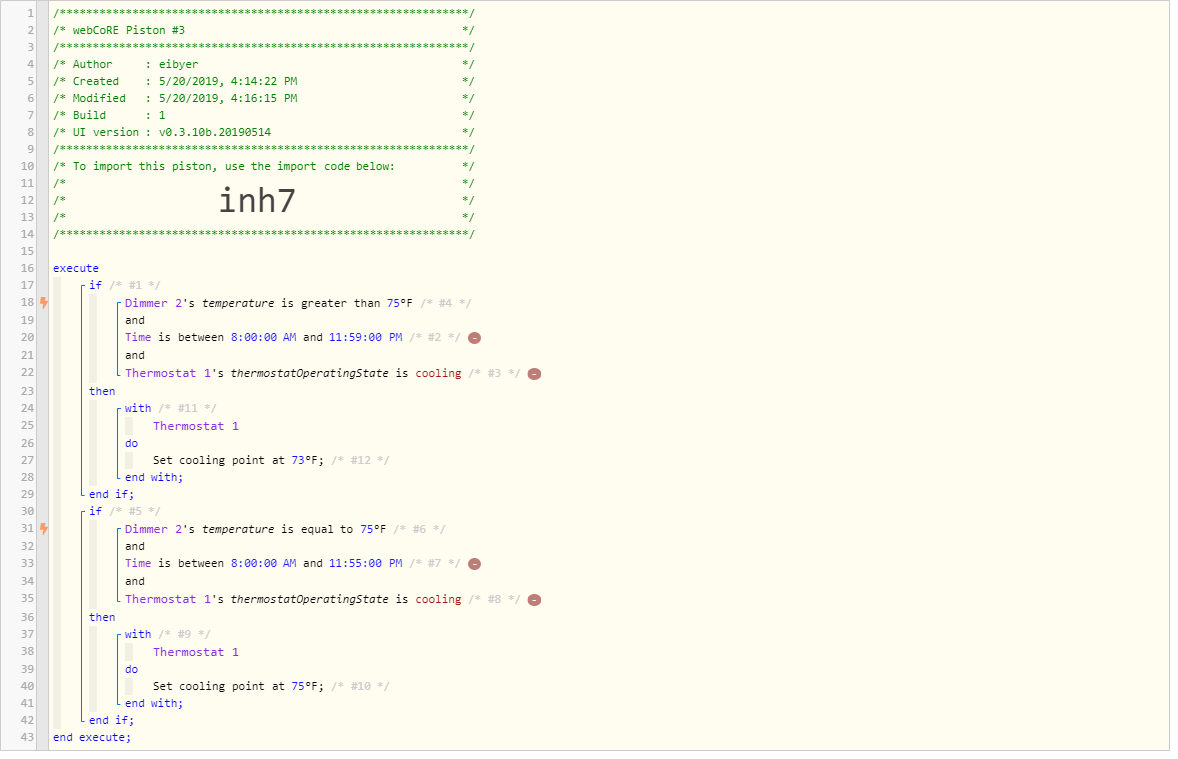

You should be using A TRIGGER and after that CONDITIONS…
I’ll share what i have for the AC system in a couple of hours…
Thank you, as I am lost!

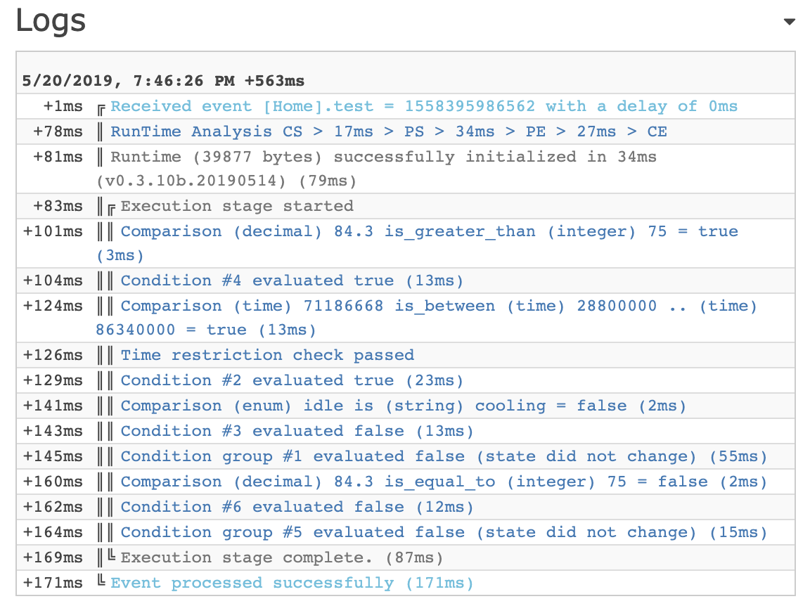

Did you notice that the Thermostat running state evaluates to as idle and not cooling. That’s why it never sets the lower cooling point.

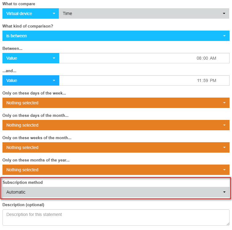

I would also remove the automatic subscription to the time and thermostat cooling state if you want the trigger to be temperature.
Just to be clear I am not sure on this advanced piston. Are there examples?
I removed automatic and made it Always Subscribe, is that what you were telling me to do?
I am not sure how to fix this.
I just re-arranged it and removed the subscription… not tested at all.

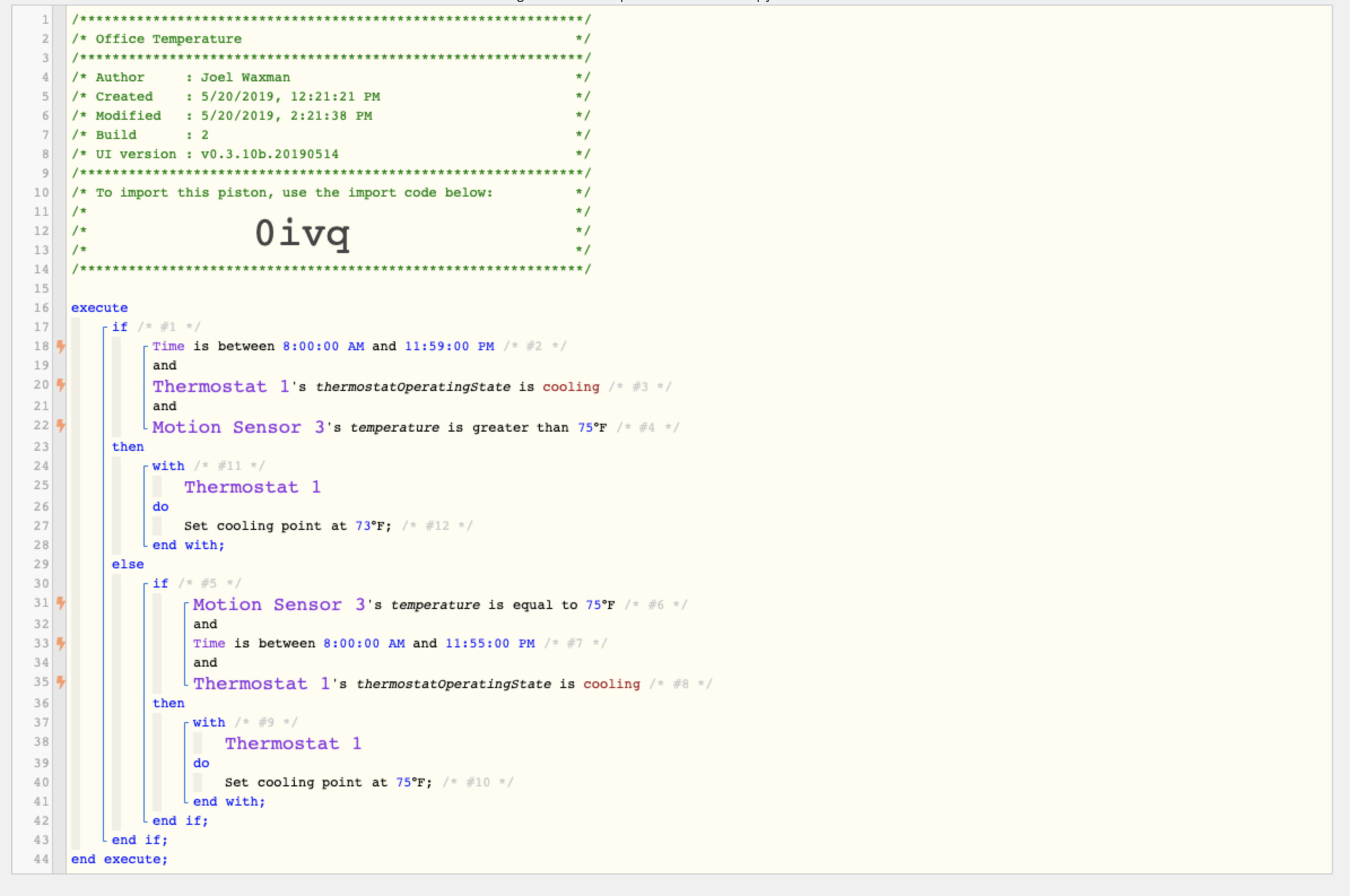

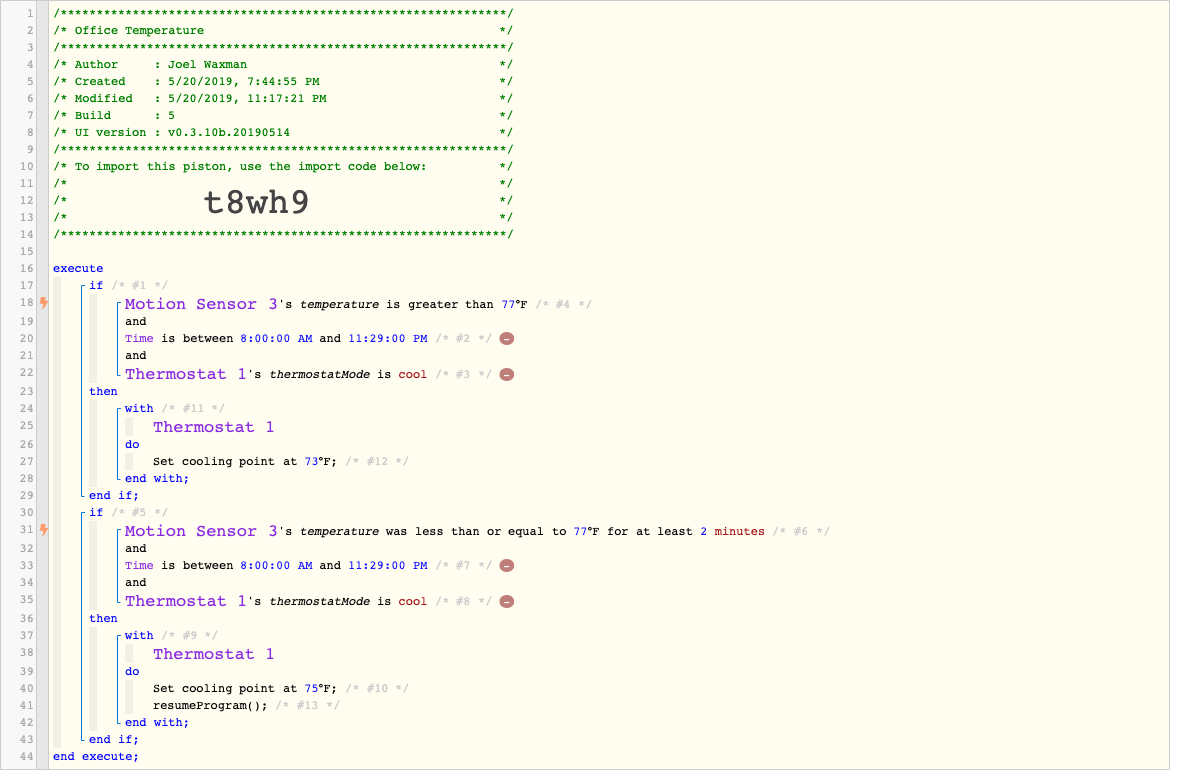

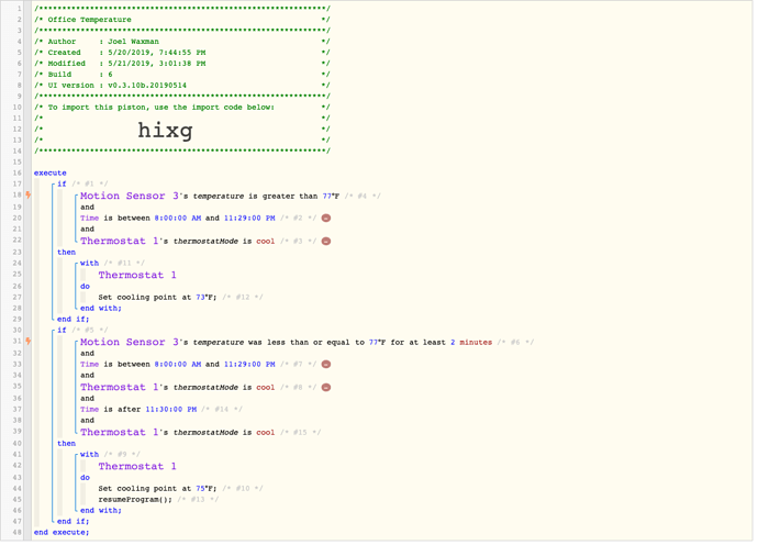

OK here is the new one using your model.
Use Thermostat mode as opposed to Thermostat Operating state.

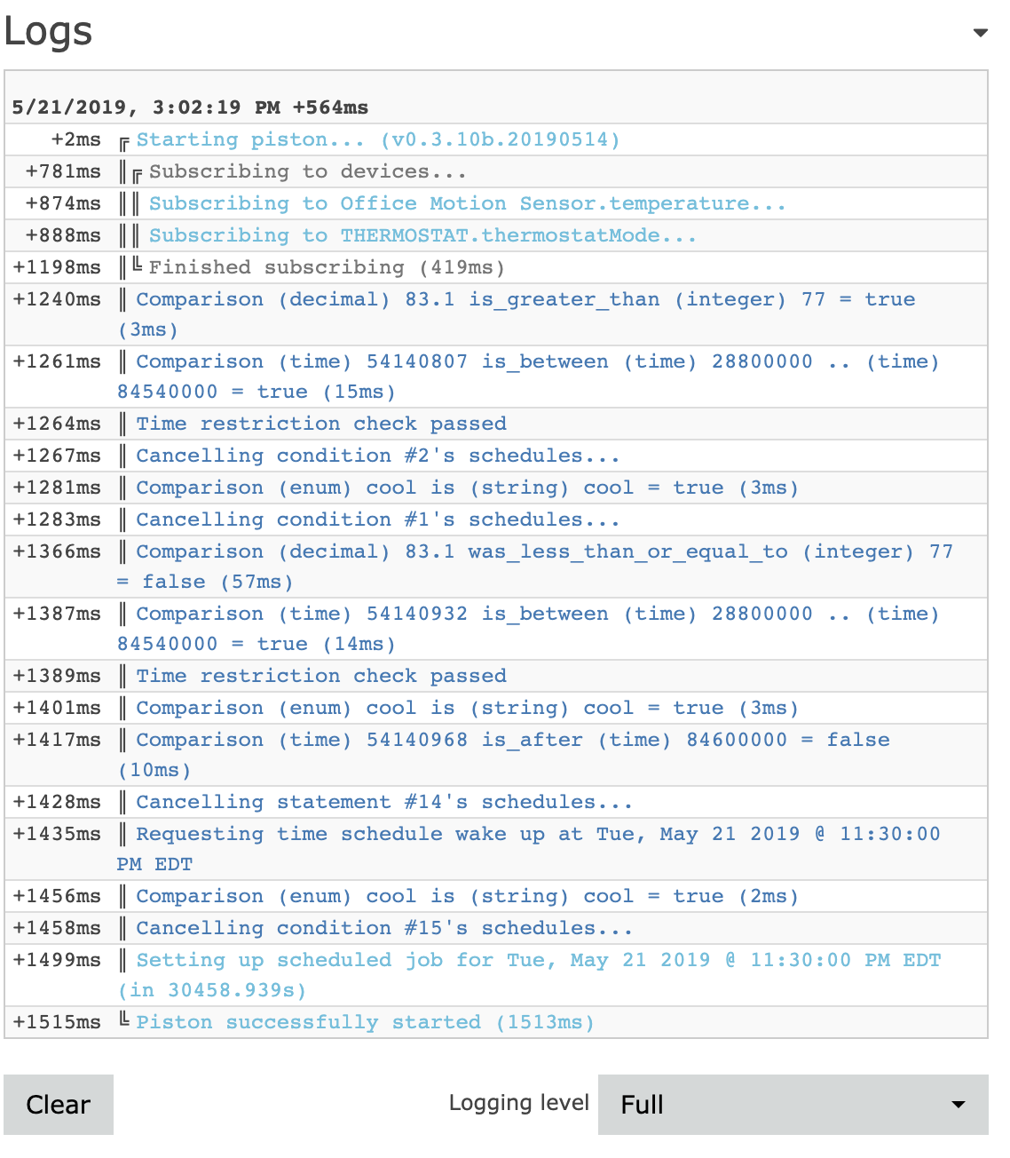

I changed it to Thermostat mode, but before I changed it the Thermostat dropped the temp and went into a temporary hold. Will the piston below prevent that, as I am not sure it will start to follow the schedule after 11:59PM. Take a look at the new piston and logs.
You will need another section to set the cooling back up if it’s still set down and you pass the 11:30 mark.

The only things I’m seeing in the piston are for between 8:00 am and 11:29 am. What I’m saying is that you need to add:
If time is after 11:30 am
and
Thermostat 1’s thermostatmode is cool
and
Thermostat:coolingpoint is less than 75
then
Set colling point at 75
resumeProgram();
end if

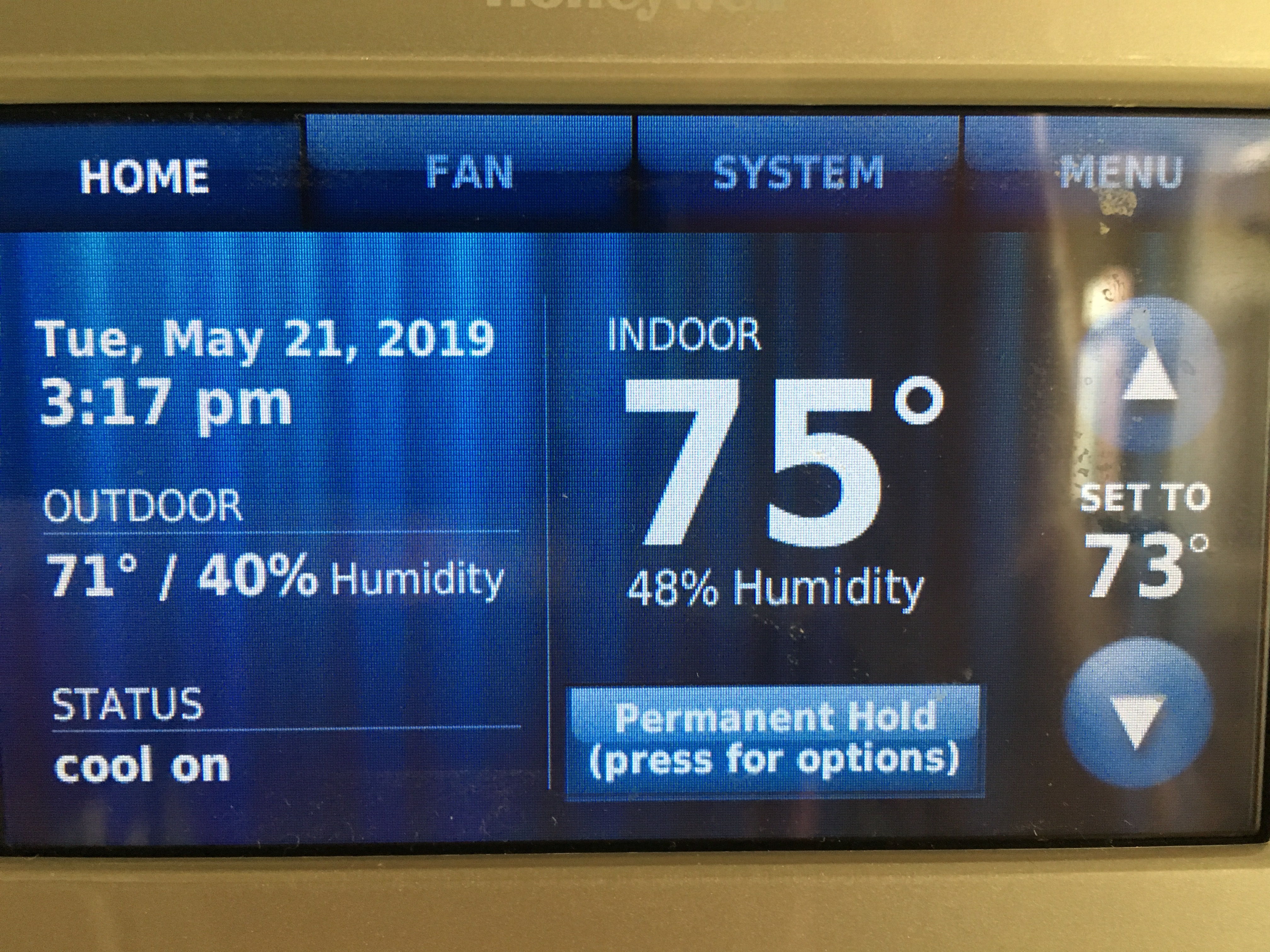

As you can see the program started but show permanent hold. Is that what it should be.

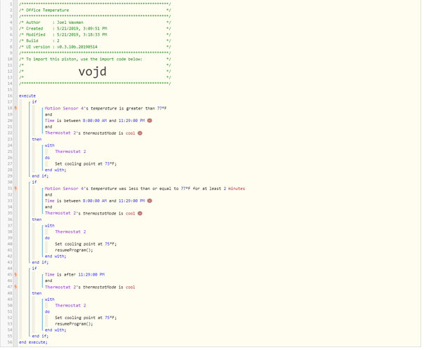

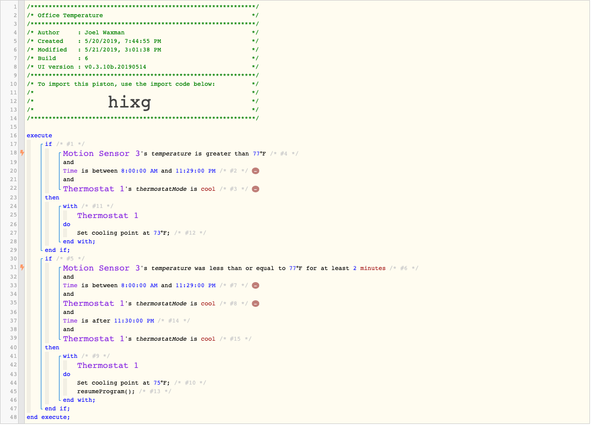

OK, please look at this and let me know if this is correct.
#20

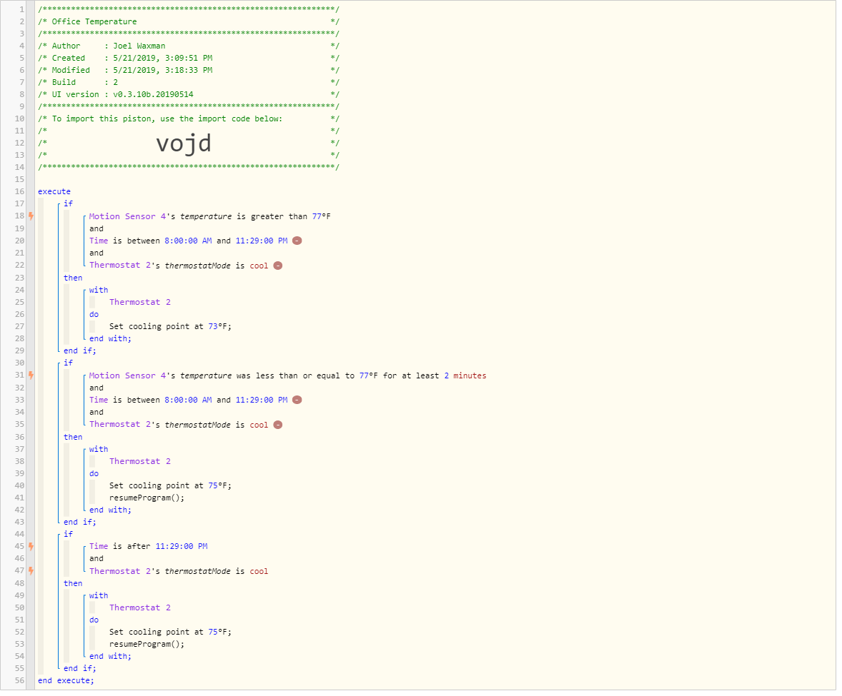

Not exactly. You need to put in a separate If with the last two conditions. The way it is right now you’re looking for the time being between 8:00 am and 11:29 pm and after 11:29 pm. Clearly, that won’t ever happen.
Try this:
