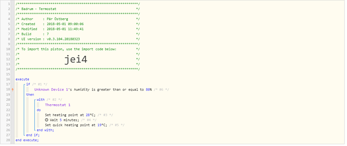

I am using a HeatIT thermostat (under floor heating termostat).
I tried with Webcore, but the thermostat doesn’t turn off the heating as I would like.
I want to do the following:
IF the humidity is over 80% THEN turn on the Thermostat and set it to 28 degrees THEN after 20min set the thermostat to 17 degrees.
The thermostat is set to 28 degrees, but is not turned off after 20minutes (I am trying with 5minutes in this example…)
I have tried both “Set quick heating point at 19” and “Set heating point at 19”
