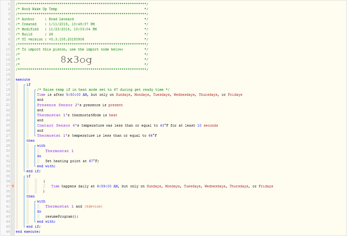

This piston works in that it controls thermostat as desired until I want it to stop controlling thermostat. The last IF statement is supposed to tell the thermostat to resume program. This has worked, but it works so well that the piston will not let manual interaction happen with the thermostat. It will not allow me to change the temp manually.
I need it to resume program after the early morning interaction, but completely release control of the thermostat until the next day.
See above

Looks to me as if it’s doing what it needs to do in the first IF group.
Then at 6:59am, it does that task…
Then it resumes doing what it was doing in the first IF group.
Perhaps your first IF should read:
  1. Time is BETWEEN 5:50am and 6:58am, but only on X days
That would make it resume the program at 6:59am.
I think that I tried and recall that it didn’t work, but I will give it another shot.
