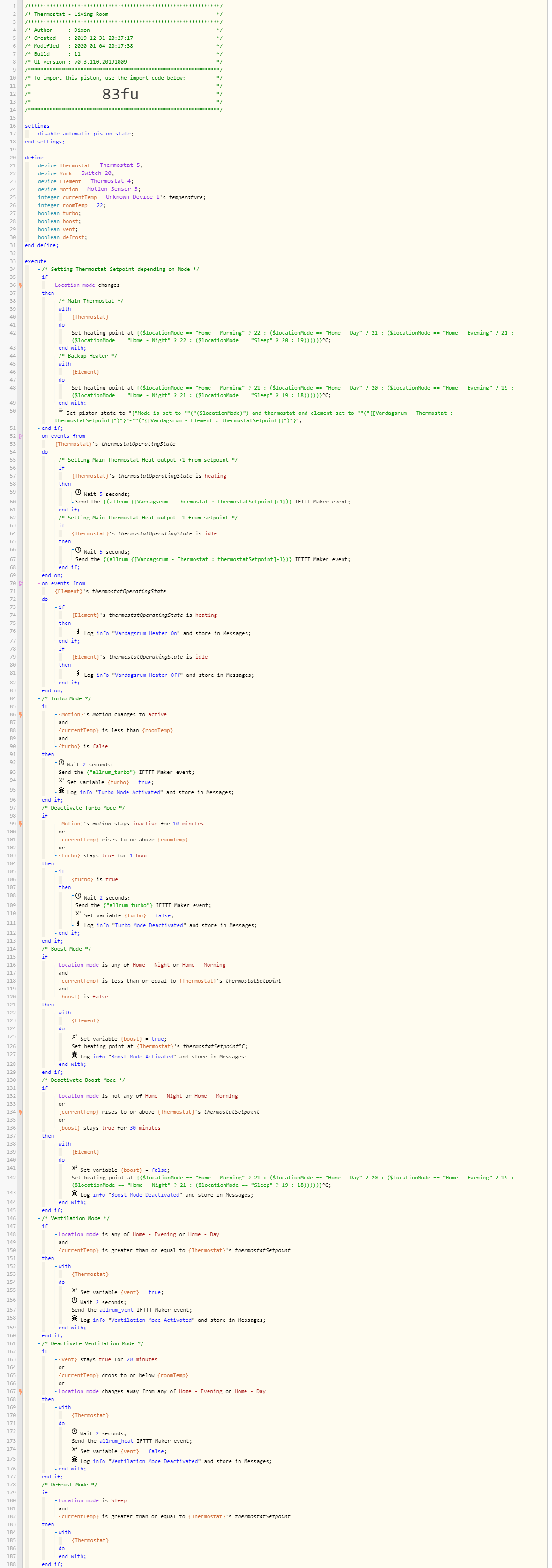

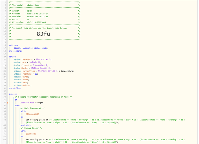

I’ve made a piston that I’ve worked with overtime, kept adding stuff I want it to contain, so basically its supposed to be a thermostat combined with a backup heater so that temp is stable throughout. aswell overtime I wanted to add in more things like cooling,defrost (its a heat pump) ventilation and such.
To have the piston to work and execute as it should, I don’t see any issues with it but perhaps something is wrong, looking for abit of help to clean up the piston
The thermostat operation state doesnt send the required ifttt command, it does work since I’ve had it running for awhile before I added boost/vent function in.
