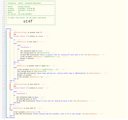

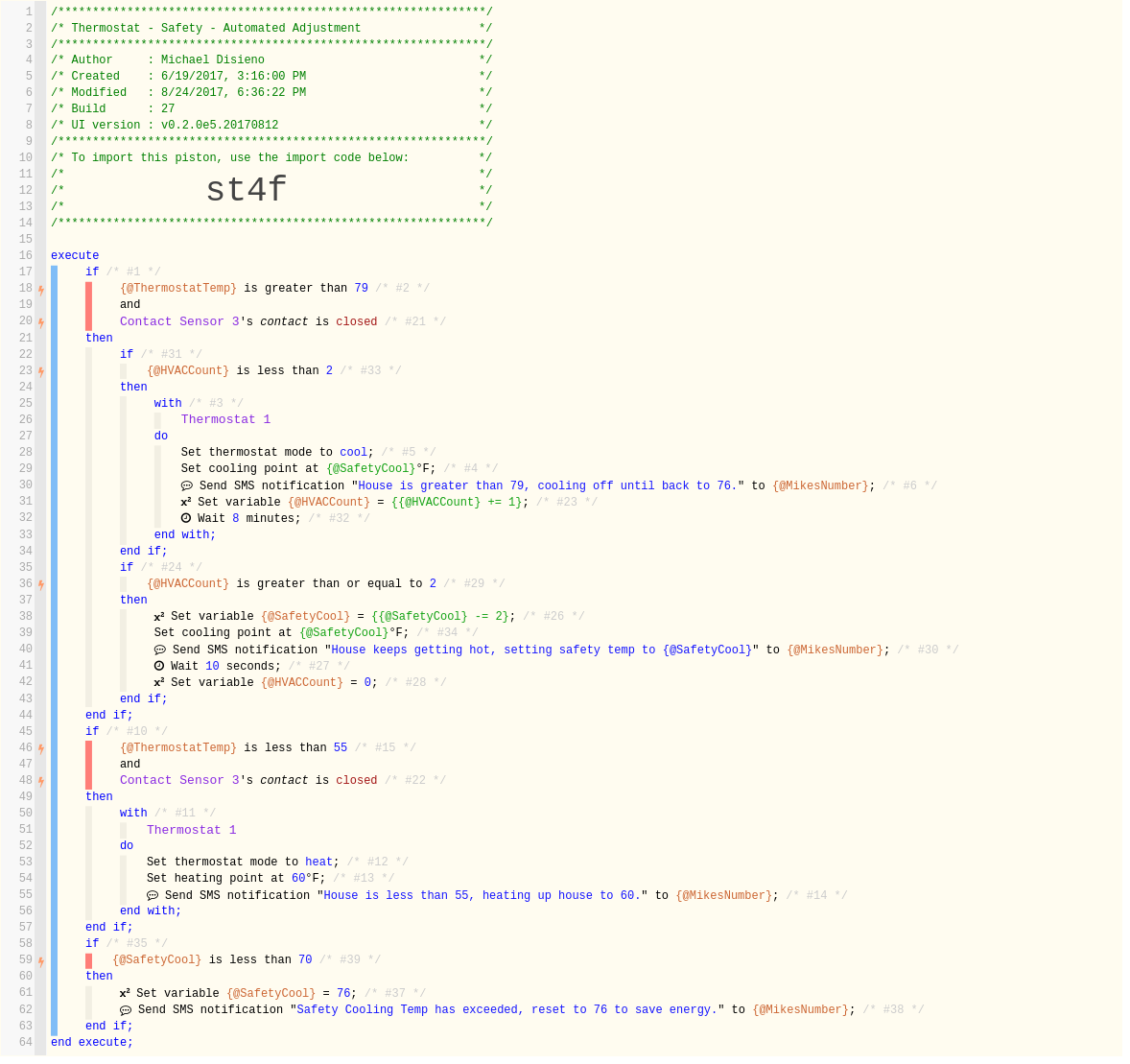

So I’m still having an issue with my piston that is supposed to change a variable called “safety temp” that the house will then cool down to if it sees the temp is too high. I find that once it finds the temp is too high, the script goes nuts and loops super fast through the adjustment to safety temp. A fresh pair of eyes might help me and if anyone has an idea on how to make my adjustment to safety temp not go off 20 times in a second.
Piston:

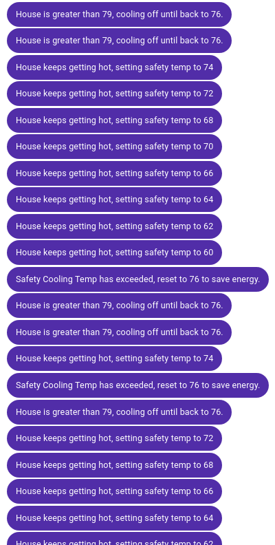

Spamming/Crazyness of SMS:
Edit: I’m going to try rises above and see if that helps. If this sounds like a good idea or not let me know.
