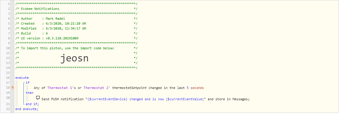

This is my first piston attempt, as I am a Wink refugee. Trying to setup (what I thought would be a relatively simple) notification for when the wife manually changes the temperature of either of two thermostats without my knowledge. I didn’t yet know how to check whether manually changed or not (as opposed to changed by schedule), so I figured I’d start out with any change in the set temp, but even that is not working.
Receive a notification of the change in set temperature through the SmartThings app.
Nothing.
6/3/2020, 11:35:22 AM +556ms
+1ms ╔Received event [Home].test = 1591198522555 with a delay of 0ms
+90ms ║RunTime Analysis CS > 29ms > PS > 49ms > PE > 12ms > CE
+92ms ║Runtime (37818 bytes) successfully initialized in 49ms (v0.3.110.20191009) (90ms)
+139ms ║║Comparison (decimal) 74.0 changed = false (30ms)
+161ms ║║Comparison (decimal) 73.0 changed = false (21ms)
+163ms ║║Condition #2 evaluated false (65ms)
+164ms ║║Condition group #1 evaluated false (state did not change) (66ms)
+166ms ║╚Execution stage complete. (73ms)
+168ms ╚Event processed successfully (168ms)

Try by getting rid of 5 seconds.
IF thermostat CHANGES
Do this do that

How do I get rid of the 5 seconds? It errors and tells me I have to put something in that field.
I have ecobees as well, but I am using the standard device handler. This is all brand new to me, so I am still learning.

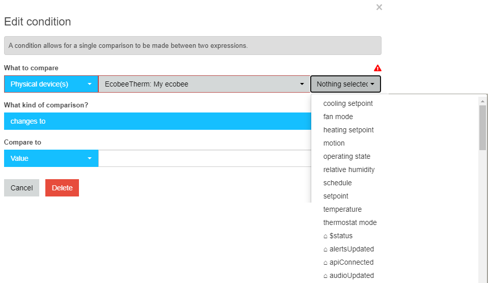

In the “what kind of comparison” where you have “changed”, use the drop down, scroll down to to “triggers” and select “changes”.
I don’t specifically recall what capabilities the stock handler has but I don’t think currentProgram is one of them. Easy way to check is when you are creating your condition and have selected the thermostat; the drop-down to the right contains your handlers capabilities.
currentProgram is a custom capability for me and is listed toward the bottom with a ⌂ indicator.
There is one other place that signifies ‘hold’ status and that is in the schedule capability. It is a longer text string that usually says something like “Hold, until 7:30pm”.
