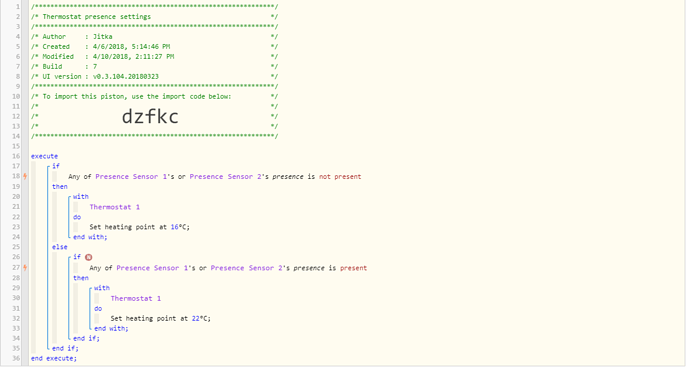

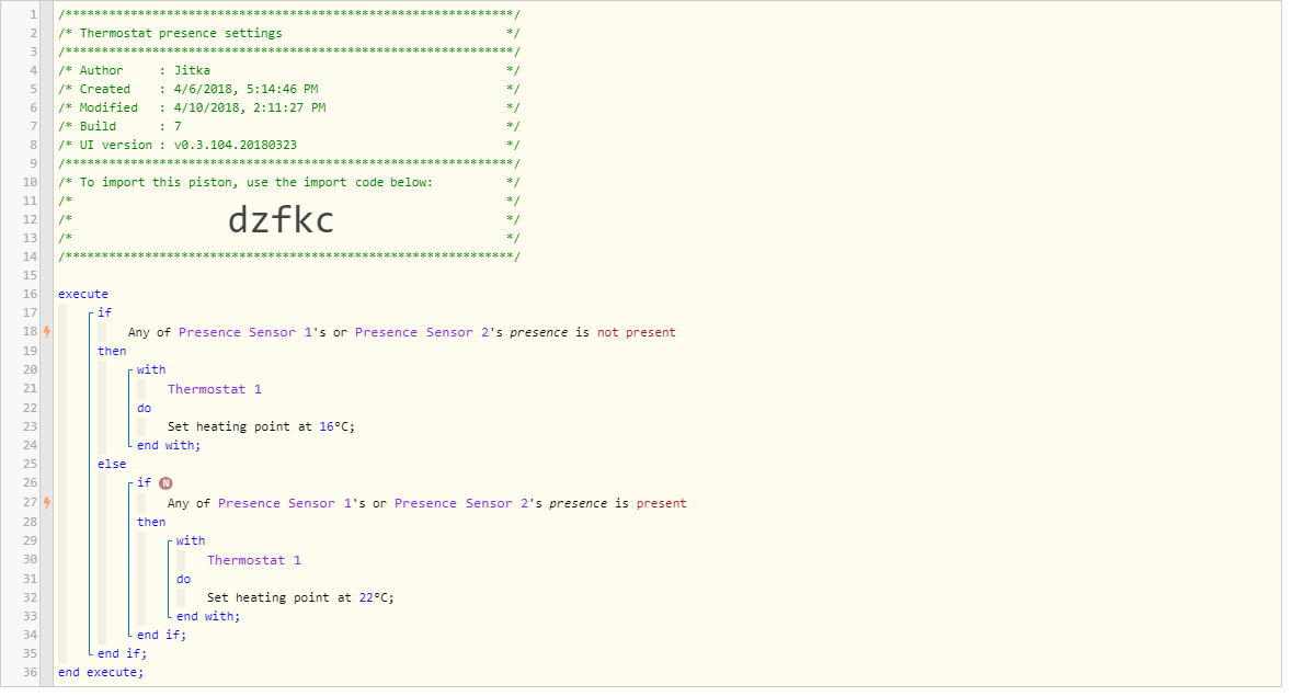

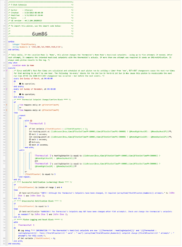

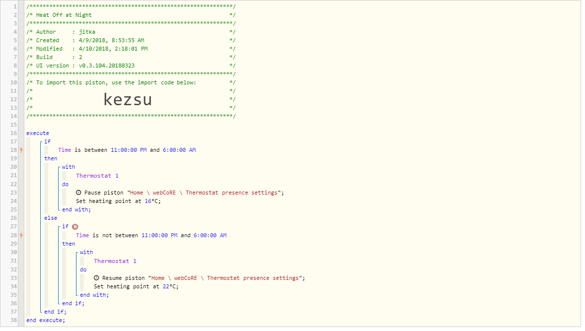

I’m trying to create piston/pistons that will control the HVAC /thermostat based on presence with some time restrictions
For now to keep it simple Heat only so if one or both presence sensors (and perhaps in the future occupancy sensor) is active then the heat will be set to 22C, both people gone or at night 11pm-6am the temperature will drop to 16C.
Created 2 pistons to do this.
Is this design OK or anyone with better ideas? ( in the future I like to get auto AC/Heat switching based on outside temperature)
