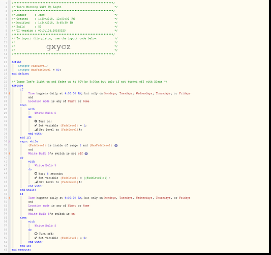

This piston was working perfectly until two days ago
The piston was humming along perfectly until two days ago
It turns on the lights at 4:50 am a gradually comes to 80%.
The light isn’t turning on at all in the morning now.

Can you still control the light bulb through ST?
Yes, I have it setup also using Room Manager for the rest of the day and that is working.
Enable Trace on the piston so we can see the trace condition #s
Well, I think that I figured it out! The last two nights my hubbie was up past when the house goes to sleep and the Mode is changed to Night. So when he said “Good Night” to Alexa, it changed the Mode to Tom’s Bedtime. Normally this happens that he goes to bed before the house and the Mode is eventually set to Night. In the piston, it is set to run if the Mode is Night or Home and in the morning the Mode was still set to Tom’s Bedtime so it wasn’t firing. I have added Tom’s Bedtime to the Modes to run. I will see what happens tomorrow.
