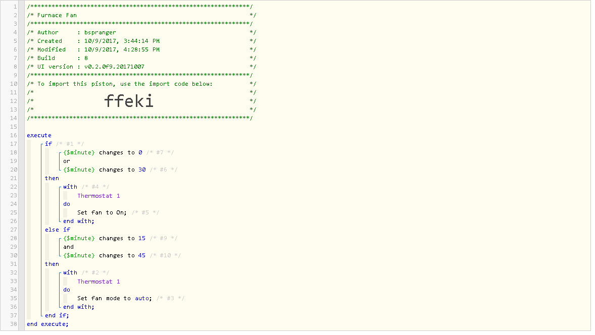

Time Based Pistons ($minute)
This piston does not subscribe to any events. Unless executed by other means, it will never run on its own.
$minute with triggers (“changes to”) should schedule an event
piston does not run because it is not subscribed to an event
Quick facts
Piston state: false
Last executed: 10/9/2017, 4:18:33 PM
Next scheduled: never
Subscriptions: no events, 1 control
Devices used: 1
Memory used: 12% (11653 bytes)
External URL: (click to open/execute)
Did you try forcing it to subscribe?
$minute as a system variable may not be subscribable. try this:

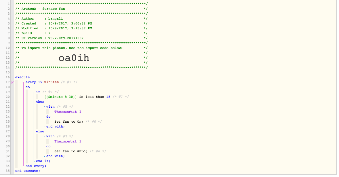

Will do, how do you get the every 15 minutes command?
timer.
This seems to have worked for scheduling the piston.
Thanks!!
great.
