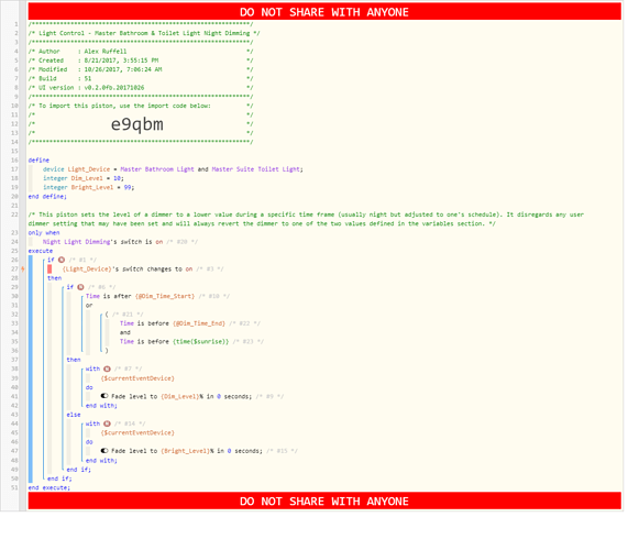

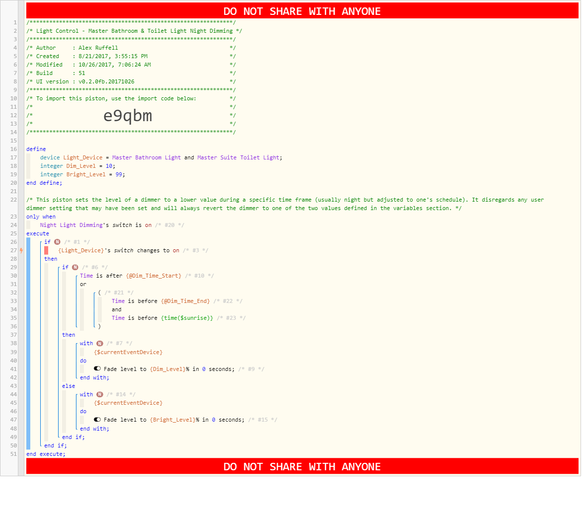

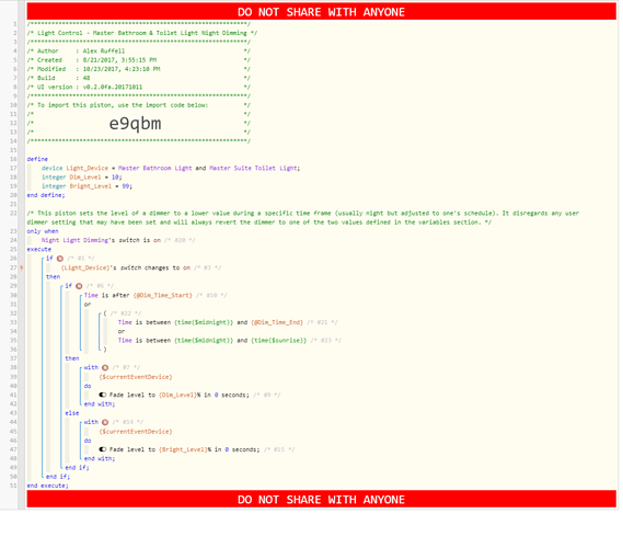

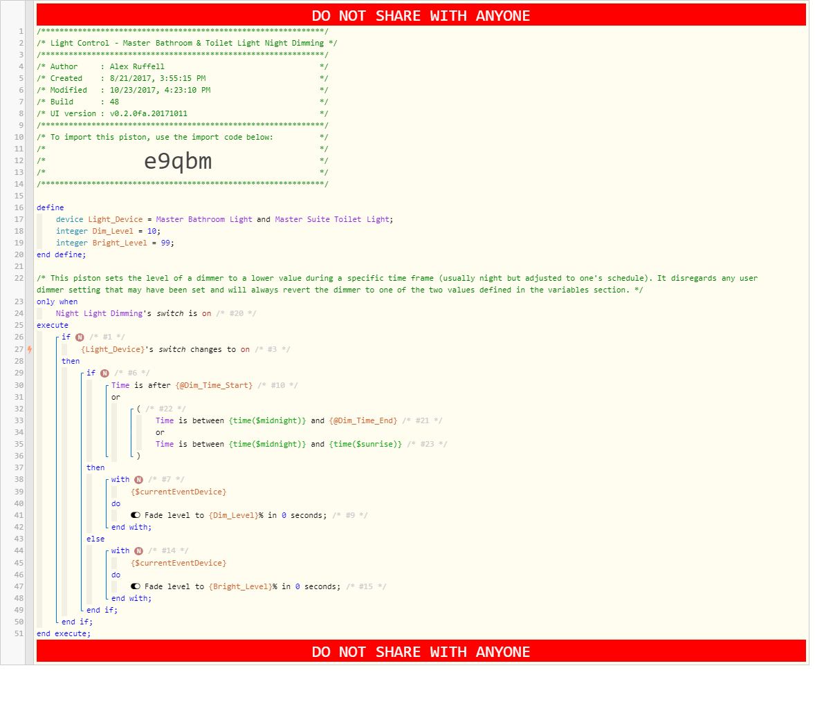

I am trying to dim my lights between 9pm and 6am or between 9pm and sunrise. I have tried many different permutations but it keeps working incorrectly. It could be unrelated to my code but I suspect I am just making a basic logic error
Evaluate to true when the current time is between either one the two ranges. The start time of the range is typically the same while the end time of the range will either be sunrise or a set time,
At this point I do not recall the exact behavior of the code as it is right now, but in all its permutations it was either working between start and midnight and not afterwards or between midnight and the end time but not before midnight. Or something along those lines… I am not typically up at night testing this. I think I am having issues with the fact the range spans across 2 days and I am therefore making an incorrect logic test. OR… it is due to me not knowing how to use time/datetime variable types

Do you by chance have location modes that correspond to the time slots you are trying to set?
Also there are presets for midnight/sunrise/sunset
As modes I only have home, away and night I believe but I really don’t use them and did not intend to use them in this piston (if I did).
What I am trying to do is simply dim the lights if any of the lights I listed are turned on between 9pm and 6am (or sunrise if earlier). The hours may change over time, especially when my baby daughter moves to her own room… so sunrise is there to ensure that when the sun light comes in through the window, the light goes on at max intensity as well.
Only reason I brought up modes is because you can limit tasks to certain modes. But since you don’t have that set up then I won’t get into that.
I would suggest using the preset values for time where you have variables like midnight/sunrise/sunset etc.
I think my issues was mixing time and datetime variables.
I found a way to strip off the date from datetime variables. I wonder whether this will work:
This seems to have fixed the issues:
