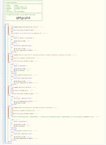

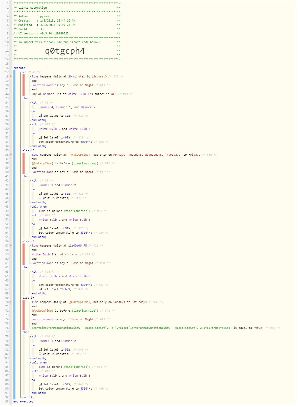

Greetings guys, I set up a piston to turn on lights based on a global variable, but when it starts to evaluate the time it returns false even time is correct. Did anyone has similar problems? Thanks in advance for help.
Time happens daily is not firing in the weekend condition, especially, according to the stack trace/log, the time comparison is evaluated to false rather than true.
Infact I have 2 very similar IF conditions, one is for weekday timed activity and one is for weekend, they are subscribing to the same time variable, @wakeUpTime. But when the same condition is evaluated at the weekend condition, it’s evaluated to false (+264ms) while weekday time is evaluated to true (+233ms). Logs attached below.
Time happen daily should evaluated to true.
Time evaluation is not evaluated correctly.

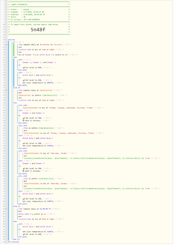

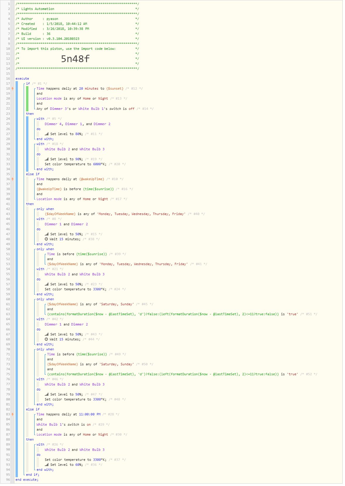

So with seperate IF blocks failing, I tried to merge weekend rule with the weekday one with only when clause controlling day of week and time constraints. This time it works perfectly. But this is more like a workaround with the problem, this time subscription issue still exists.
Working pistion:
