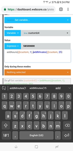

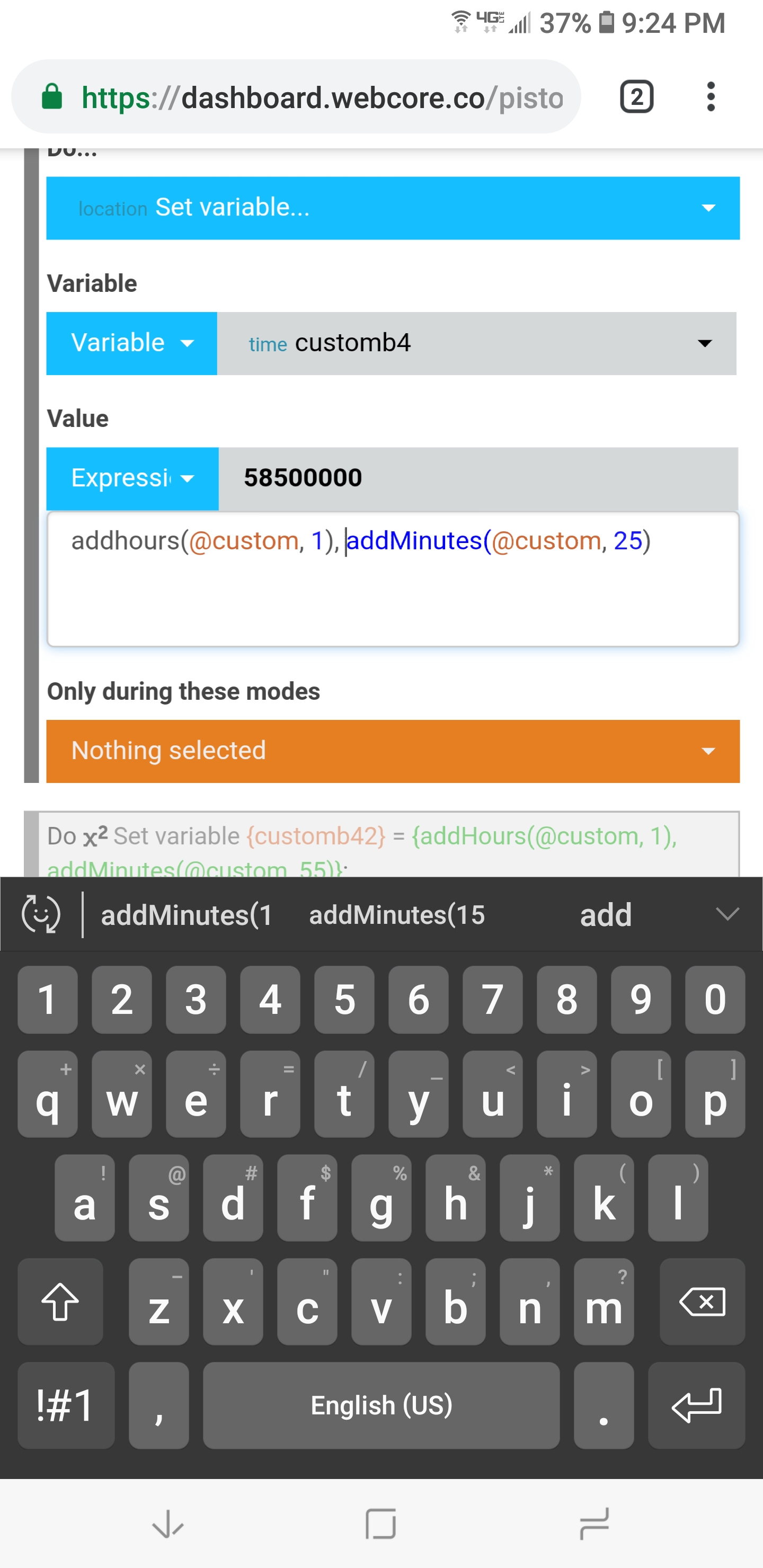

This should be an hour and 25 minutes why is it adding up to 10 hours later?!?! What am I doing wrong?
Time Isnt adding correct

I believe the “H” in addHours is supposed to be capitalized…
If that doesn’t fix it, it would help to know what is stored in @custom
guarddog13
That didn’t fix it. @custom is a time only variable of 5:30am. It should be changing customb4 to 6:25am but is changing it to 4:15pm.

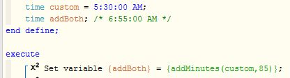

Here are three solutions, with the easiest at the top…
Why not simply use:
addMinutes(@custom,85)
Like this:

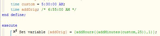

Alternatively, if you need hours and minutes separated, you can do the math inline like this:

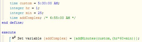

And since there is so many ways to do stuff in webCORE, this is likely what you were aiming for originally:
(but the extra parenthesis may be a bit confusing to some)
