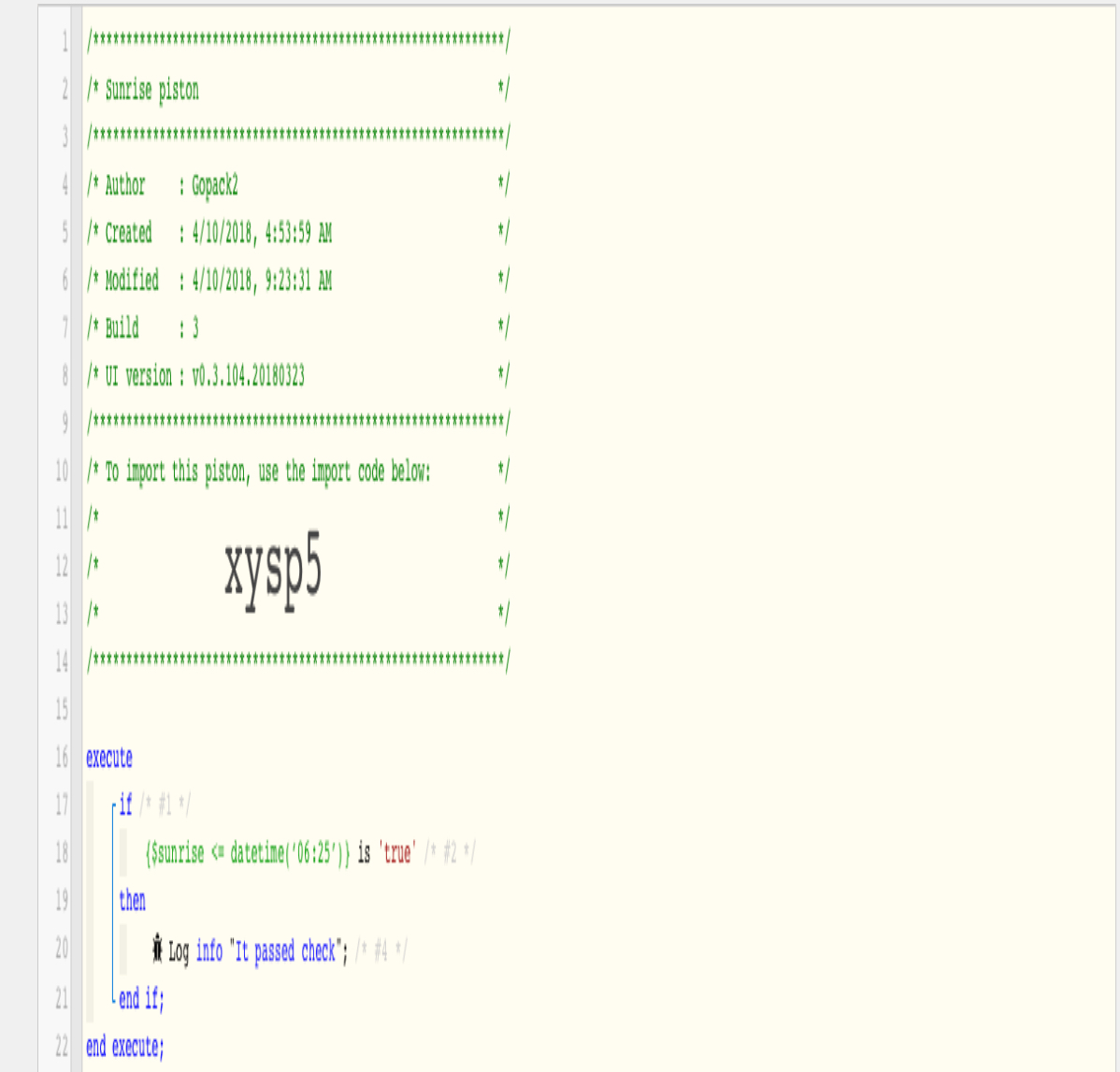

Thank you. Does anyone know how to fix this?

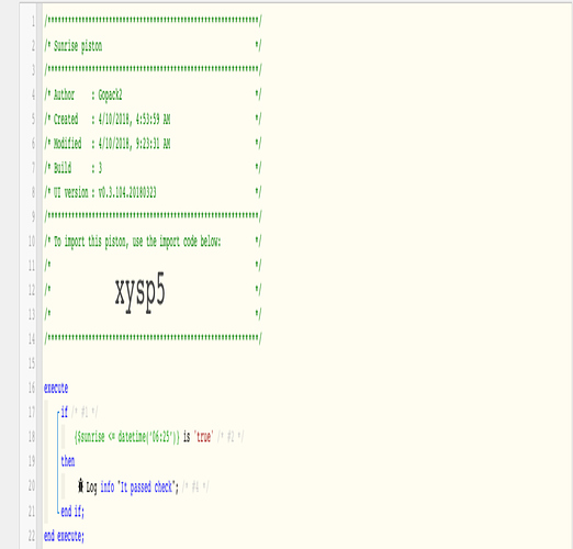

I$sunrise <= datetime(‘06:25’) Triggers if sunrise is greater or equal to 06:25
$sunrise >= datetime(‘06:25’) Triggers if sunrise is less than or equal to 06:25
If you look in your webcore console there is a list of functions in there with the values returned. $sunrise will show you what is being returned for sunrise. Both date and time
Thank you. I couldn’t work out how to enter it the same way as you. Will this work the same?
time
I’m not sure on mobile right now. When building the piston. Where you are entering $sunset. Click in the option for value and a drop down will open. Select expression and it should let you enter the way I showed earlier.
Try restoring this piston with backup code. Then click on the statement and see how done. Also fin there modify to your needs
