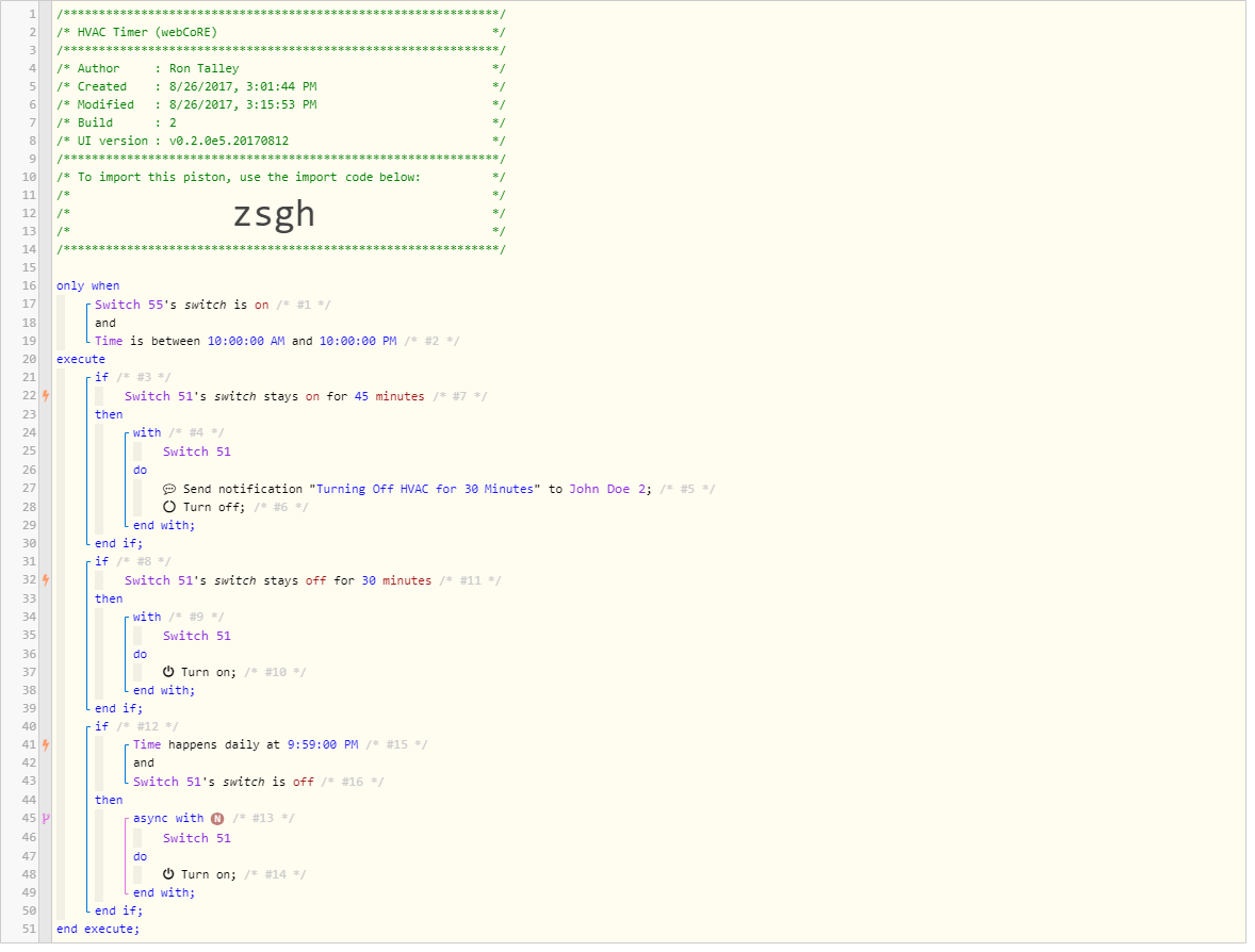

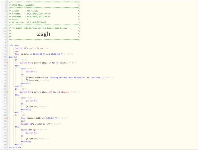

I have, what I thought would be a simple Piston, but for some reason, the time restriction is not working in this Piston. I want to toggle my HVAC Virtual Switch on an off during 10am and 10pm to force it to only cycle on and off during a 45 minute window then shut the system down for 30 minutes.
The issue is, the Piston keeps going even after 10pm.
