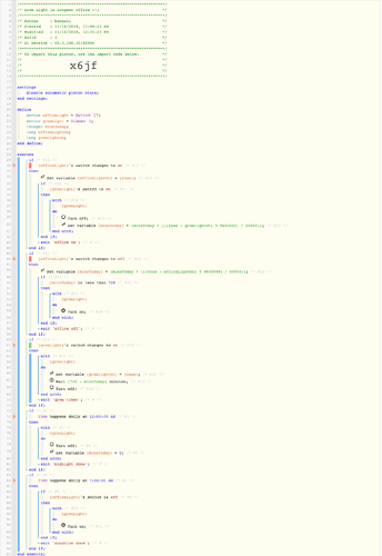

Basically the situation is as follows: My home office has no access to natural sunlight, but I still put some plants in it and am trying to have them get sufficient light without “just” keeping the lights on for 24 hours.
The aim is to have them receive 10-12 hours of light a day, DURING the day. So no light between say midnight and 7am.
Now, what I would like to program: When I am at home and present in the home office, the light will be on (because I dont work in the dark) and I want that “on time” to be attributed to the 10-12hr/day contingent. If the light is off, it means I am elsewhere, in that moment I want the “grow light” to kick in. At this moment I am just thinking of having my Hue’s turn on with the Fuchsia style, without the green LEDs, which apprantly are not necessary to grow plants.
After the 10-12hrs are up, OR after it turns midnight OR while I manually turn on my normal working light, I want the grow light to turn off.
Because I have not figured out variables yet I am at a loss on how to put this onto practice.
How would you go about it?
