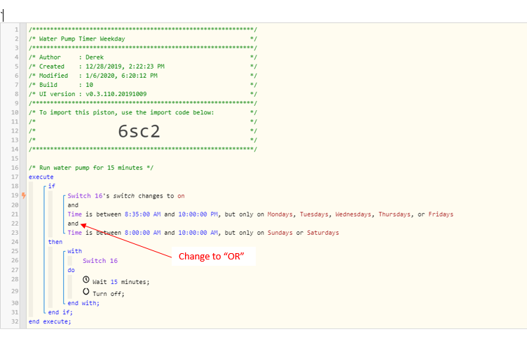

Timer at different times on the Weekend
How can I change the AND at line 22 to OR so I can have a timer happen at different times during the weekend?

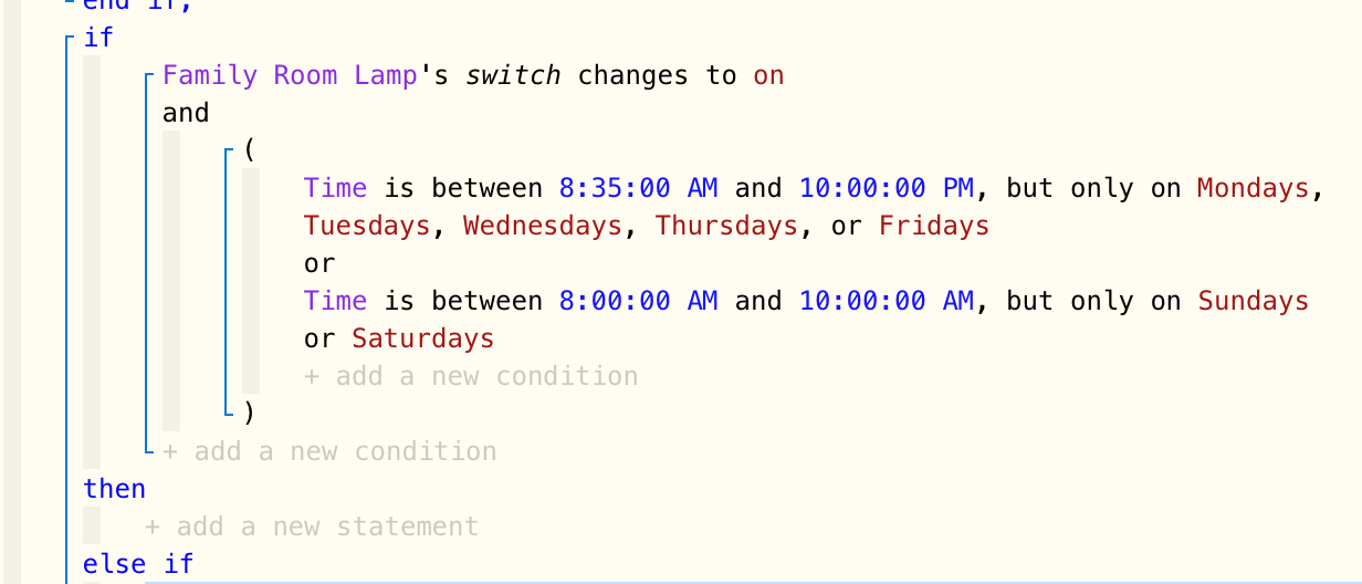

You need to change the second condition to a group, something like this.
@Moe67 Thank you for showing an example, it was very helpful
