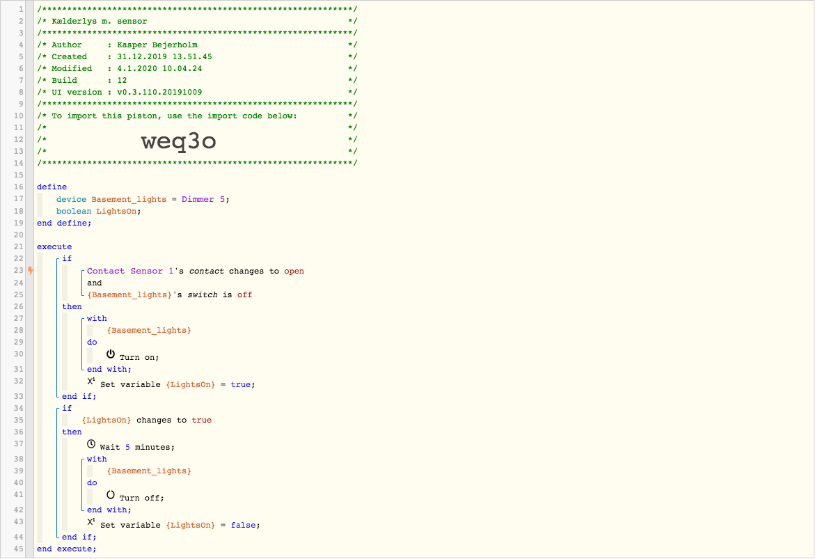

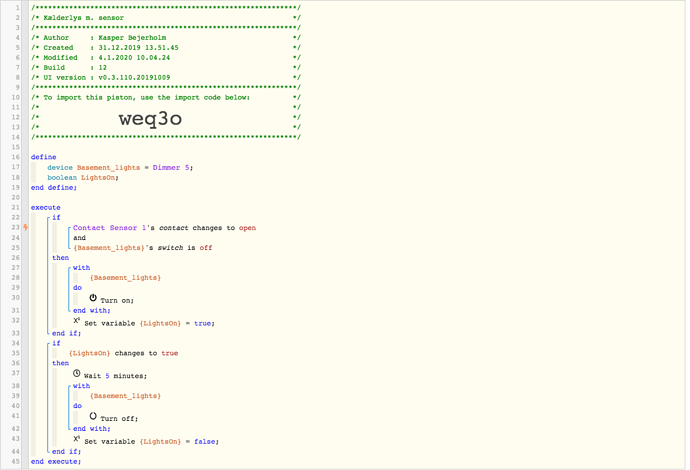

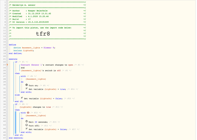

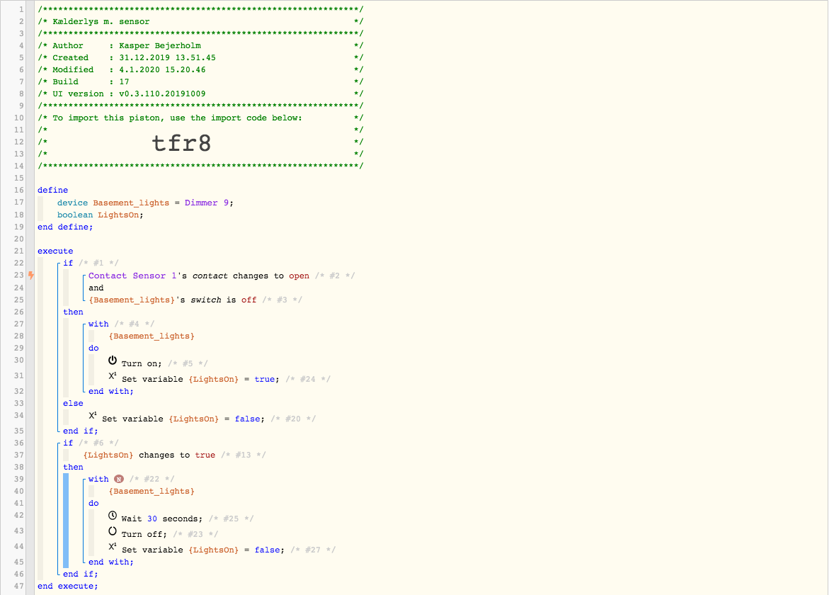

Piston is designed to start a timer when I open the door to the basement and turn off after 5 min. It seems that the timer restarts when i come back up the door after having picked up what i needed.
Timer only starts first time I open the door and the light switch is off.
Essentials of piston works - lights go on, lights go off, but behaviour of timer is resetting when opening the door again even if the lights are already on.
