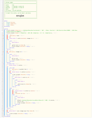

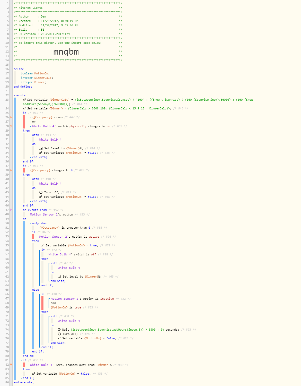

My piston isn’t deciphering physical from digital/programmatic changes.
Lights should stay on if a physical switch interaction is detected after they were turned on my a motion sensor. If no physical interaction, they’ll turn off after a period of time without motion.
In the example below there were two event. The first is the motion sensor turning on the lights. The second, I’m not sure why that is happening. It almost seems like a response from the switch that’s being processed as a new action rather than a response from the piston turning it on.
The piston is turning the light on, which is almost immediately followed by a light switch event re-triggering the piston. This light switch event is deemed physical by webCoRE but appears digital in the ST logs.
Appreciate any help here. I’ve been WAY over my head tinkering with DTH stuff to get this to work. I thought once I had the switch interactions reporting as digital rather than physical, I’d be home free.
