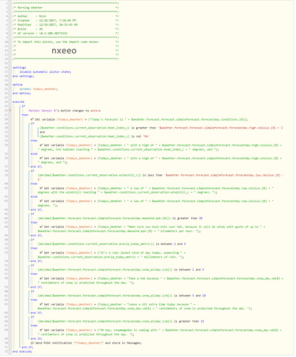

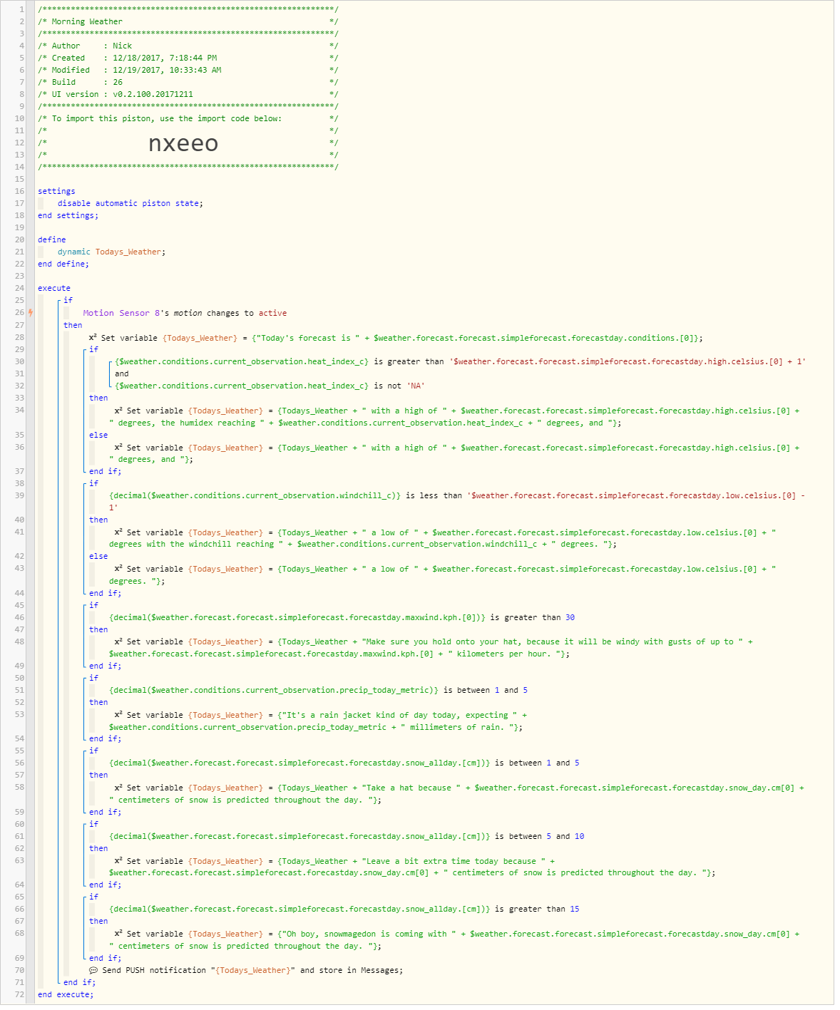

I’m working on creating a piston that will announce (right now its a push notification, eventually text to speech over Sonos) the weather when my motion sensors first sense motion in the morning. I think I’ve got it mostly setup, but I’m not quite sure how to differentiate between rain and snow.
For snow, that’s an easy one - $weather.forecast10day.forecast.simpleforecast.forecastday.snow_allday.[0]
But for rain, there is no explicit way of returning rain (vs snow). The closest I can find is $weather.forecast10day.forecast.simpleforecast.forecastday.qpf_allday.[0]

EDIT: using $weather.forecast.forecast.txt_forecast.forecastday.fcttext_metric.[parameter] will return the next 1/3 of the day, so that should work! Playing with the time that the forecast is checked, as well as storing in parameters will allow me to get very close to what i want.
I use contains() to match the simple conditions with ‘rain’ or ‘thunderstorm’. For snow I match ‘snow’ or ‘flurries’ or ‘sleet’. For sunny… ‘sun’ (which covers sunny, mostly sunny, etc) and ‘clear’.
