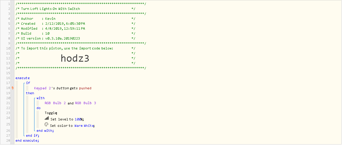

Trying to figure this out and can’t seem to get it. I have a piston that does a simple toggle of my LIFX lights. That works fine.
What I’m trying to do is adjust the color and levels when it goes into the on state. The problem is when it goes into the off state it turns it back on again because of the level/color steps in the piston.
Is there a way to only make it adjust color/level when its in the on state of toggle, and just turn off when its in the off state of toggle?
First button push turns on lights, adjusts level and sets color. Second button push only turns off lights. Third push will turn on lights, adjust level, set color, etc.
First toggle turns on light, adjust level, sets color, second turns off lights, and then turns them back on immediately and adjusts level and color.
Attached
I think this will do the trick for you:
IF Button gets pushed
    IF any of Bulb 2 or Bulb 3 are on
        With Bulb 2 & Bulb 3, Turn off
    Else
        Set level to 100%      <-- This turns on the lights
        Set color to Warm White
    END IF
END IF
That was it! Thanks so much!
