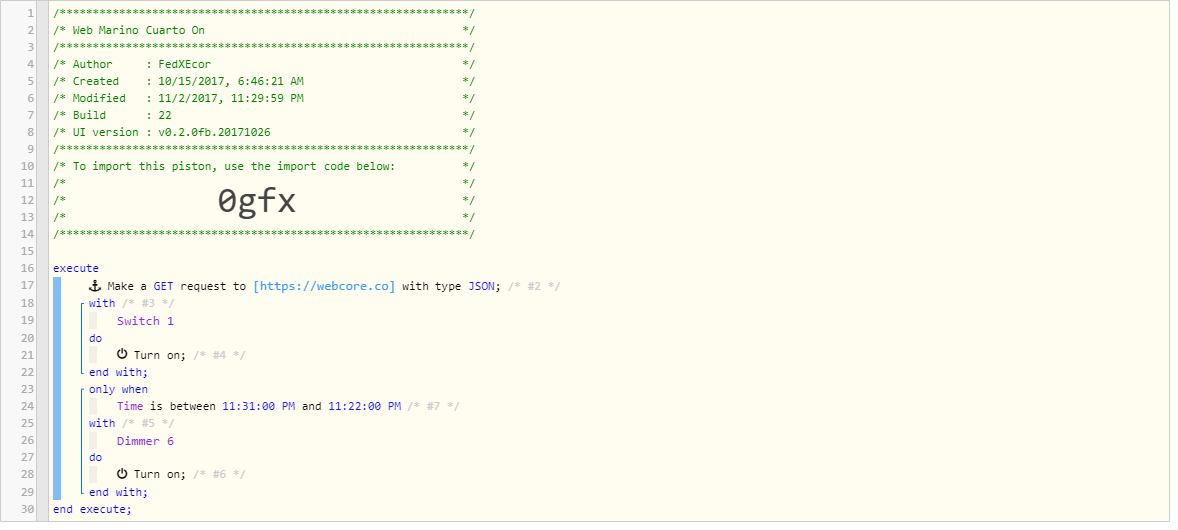

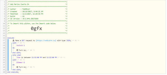

Update: the piston image i uploaded is from a new piston i made. instead of having the time as an “if” i set the time to “Only when” but its not triggering the lights anyway.
it does not trigger when time is between 6 pm and 6 am instead it triggers at 5:59 pm and 5:59 am “AUTOMATICALLY”(Not only when external URL has been executed)

without the Time everything works fine but if i add the time it triggers automatically without even accessing the external url.
+1ms ╔Received event [XXXXX].execute = 177.xxx.xxx.xxx with a delay of 63ms +117ms ║RunTime Analysis CS > 11ms > PS > 35ms > PE > 70ms > CE +127ms ║Runtime (37723 bytes) successfully initialized in 35ms (v0.2.0fb.20171026) (126ms) +128ms ║╔Execution stage started +133ms ║║Cancelling statement #1's schedules... +138ms ║║Error executing virtual command [].httpRequest: (1ms) java.lang.NullPointerException: Cannot invoke method replace() on null object +143ms ║║Cancelling statement #3's schedules... +162ms ║║Executed physical command [Plug 1].on() (15ms) +162ms ║║Executed [Plug 1].on (17ms) +171ms ║║Comparison (time) 81804924 is_between (time) 84660000 .. (time) 85440000 = false (4ms) +172ms ║║Condition #7 evaluated false (7ms) +173ms ║║Condition group #5 evaluated false (state did not change) (9ms) +174ms ║╚Execution stage complete. (46ms) +184ms ╚Event processed successfully (184ms)

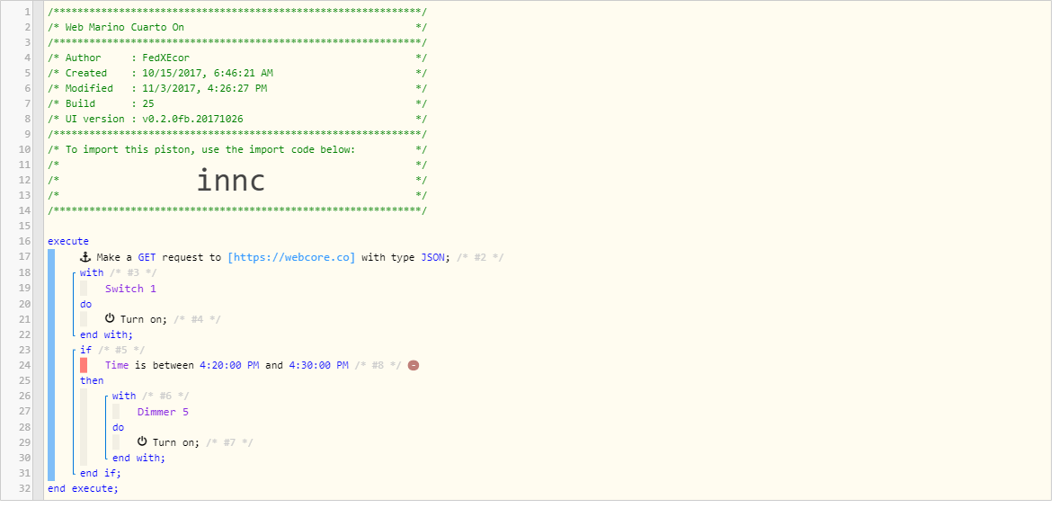

Hello, thanks for the reply!, i did change the subscription to “Never” however i’m not able to make it happen. it seems like it just doesn’t work with small amounts of time. Just for testing I am setting a difference of 10 minutes between of 4:20 pm and 4:30 pm. I triggered the piston at 4:28 pm but it didn’t turn on the light. In the logs i can see this:
“+157ms ║║Comparison (time) 55742789 is_between (time) 58800000 … (time) 59400000 = false (4ms)
+159ms ║║Condition #8 evaluated false (8ms)
+160ms ║║Condition group #5 evaluated false (state did not change) (9ms)
+161ms ║╚Execution stage complete. (36ms)”
I’m sure im missing something. Sorry for the ignorance. My time is gmt -5 could it be possible that i should be matching the piston’s time to other time region?
Thanks.
Never mind i just realized that indeed it was a problem with my time zone. Webcore’s time is one hour before mine. (here is 5:22 pm and webcore’s time is 4:22 pm) its funny i think it should be specified that the time you have to set has to be the same that webcore is based on. When i execute the piston i get “trace started on (my time zone)” i got confused. Anyway you helped me with the subscription thing cause that was messing with my piston too. Thank you!
