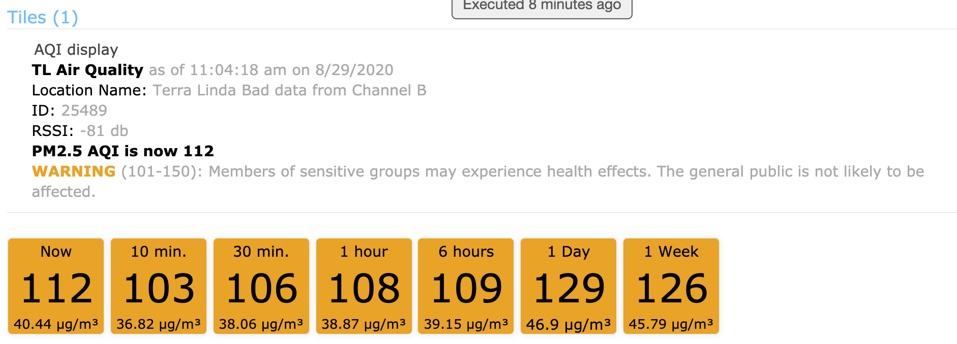

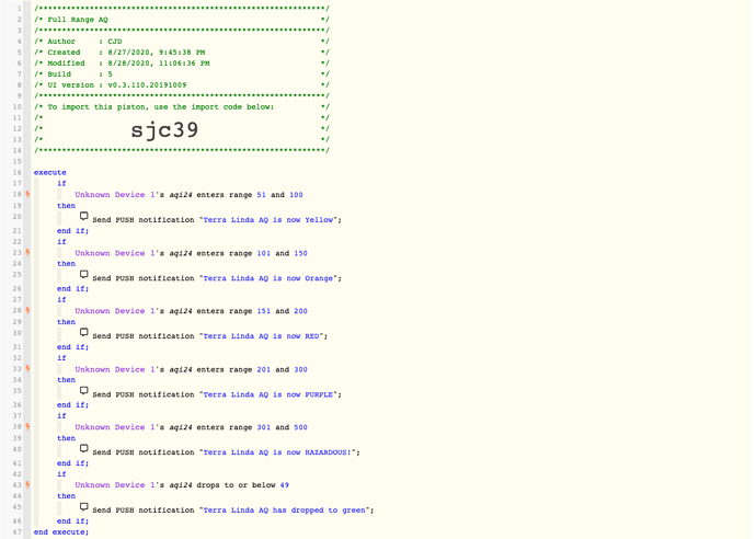

I know this will end up being something stupid, but I’m now in hour 4 of trying to get this piston to work. I previously had the piston trigger by a timer running every ten minutes. That worked but resulted in a notification every ten minutes regardless of movement.
To fix the constant notifications, I took the time trigger out and changed the ranges to movement triggers, but now I am not getting any notifications. I am in the middle of several California wildfires, so I am sure that the air quality has moved quite a bit, but I have not received any notifications in the last 12 hours.
I am thinking that I do not understand how the ‘enters range’ triggers work, but I don’t see an option that would be as accurate for what I am looking for.
