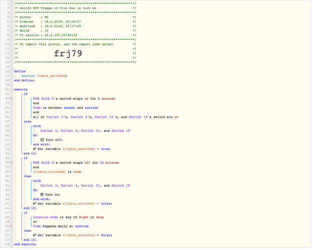

Trigger event for more than a specific time
what is the correct if trigger in line 22.
i need something like that:
“RGB Bulb stays online for 6 or more minutes”

it was a misstake. here the new:
The Hue bulb dont send commands, if you use a momentary switch to switch on/off the bulb.
so the bulb is all the time “on”. you must turn on/off about the app.
So i want to do: If the RGB Bulb 5 is on for more than 6 minutes and the other devices are also on, then switch der other devices to off. because it´s to much light :slight_smile:
if the RGB Bulb goes off, then switch on the other devices.

ok thanks. but i need still help with, because sometimes i use the normal key switch, so the bulb in smartthings log is still “on”.
If the RGB Bulb 5 is on for more than 6 minutes and the other devices are also on, then switch the other devices off.
what is the correct webcore if statement for “equal or more than 6 minutes?”
I prefer to use waits.
