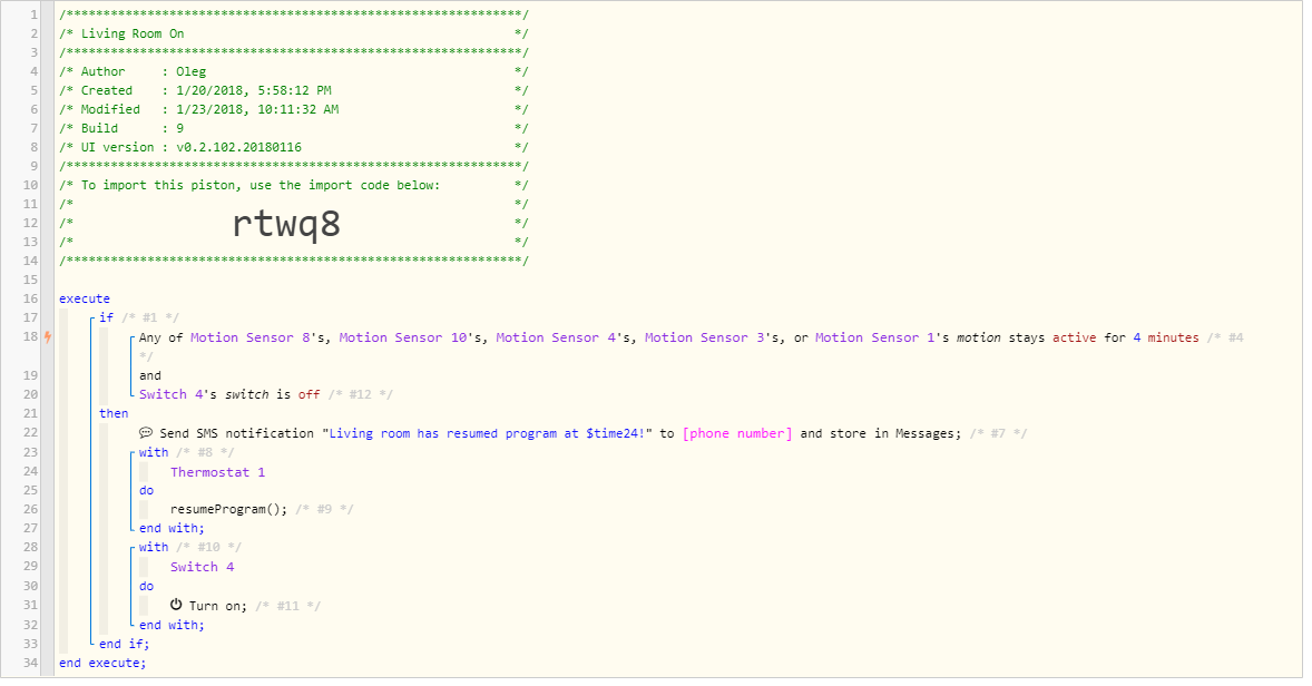

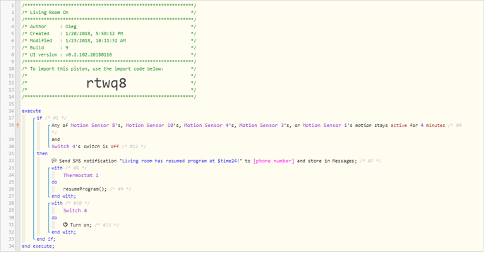

I need the trigger which would only fire if the motion sensor was triggered several times in x minutes.
I stay in the room for longer than 5 minutes and the trigger fires. However, if I simply enter the room and leave in 1 minute, the trigger DOES NOT fire.
I tried the “stay active in 5 minutes” and “stay away from inactive in 5 minutes” but I think these still fire if I leave the room right away.

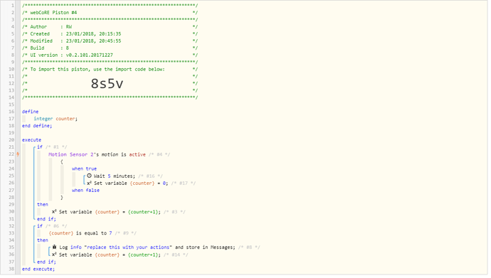

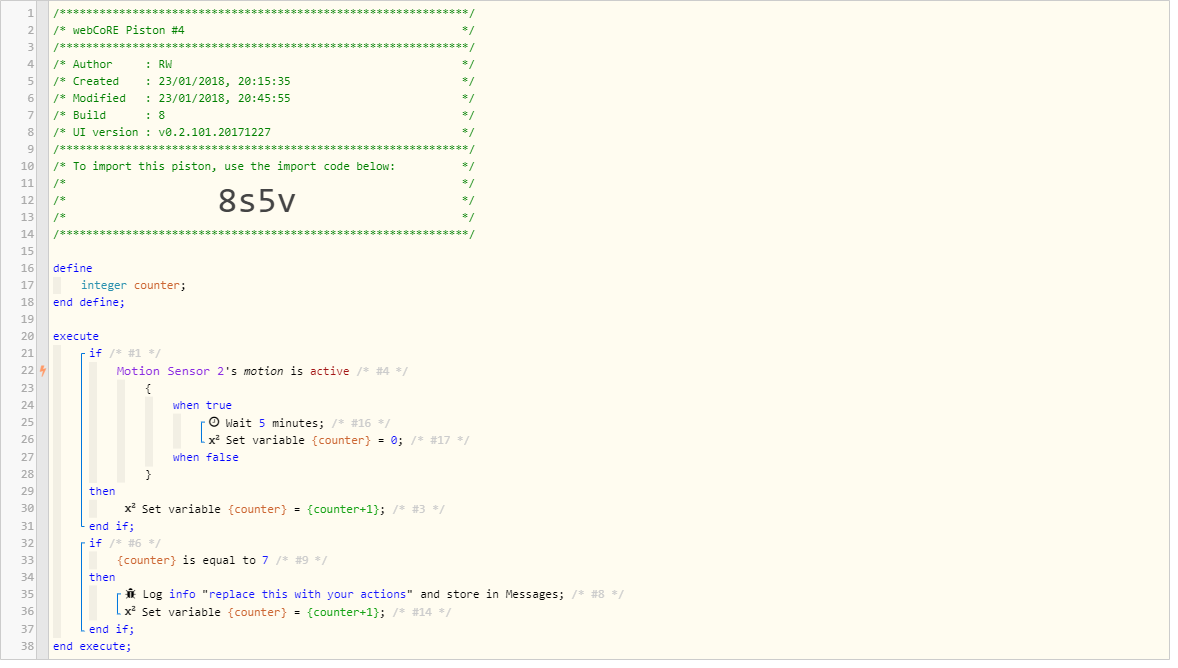

This will trigger on the 7th motion event.
Counter will reset after 5 minutes of activity.
