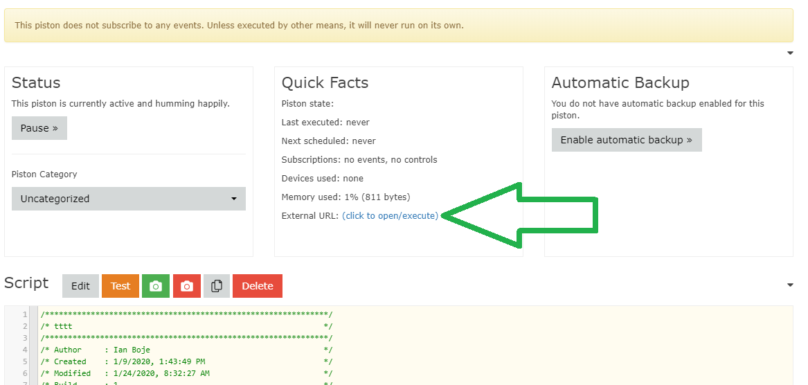

If you want Tasker to tigger a webcore piston, copy this URL on your desired piston:

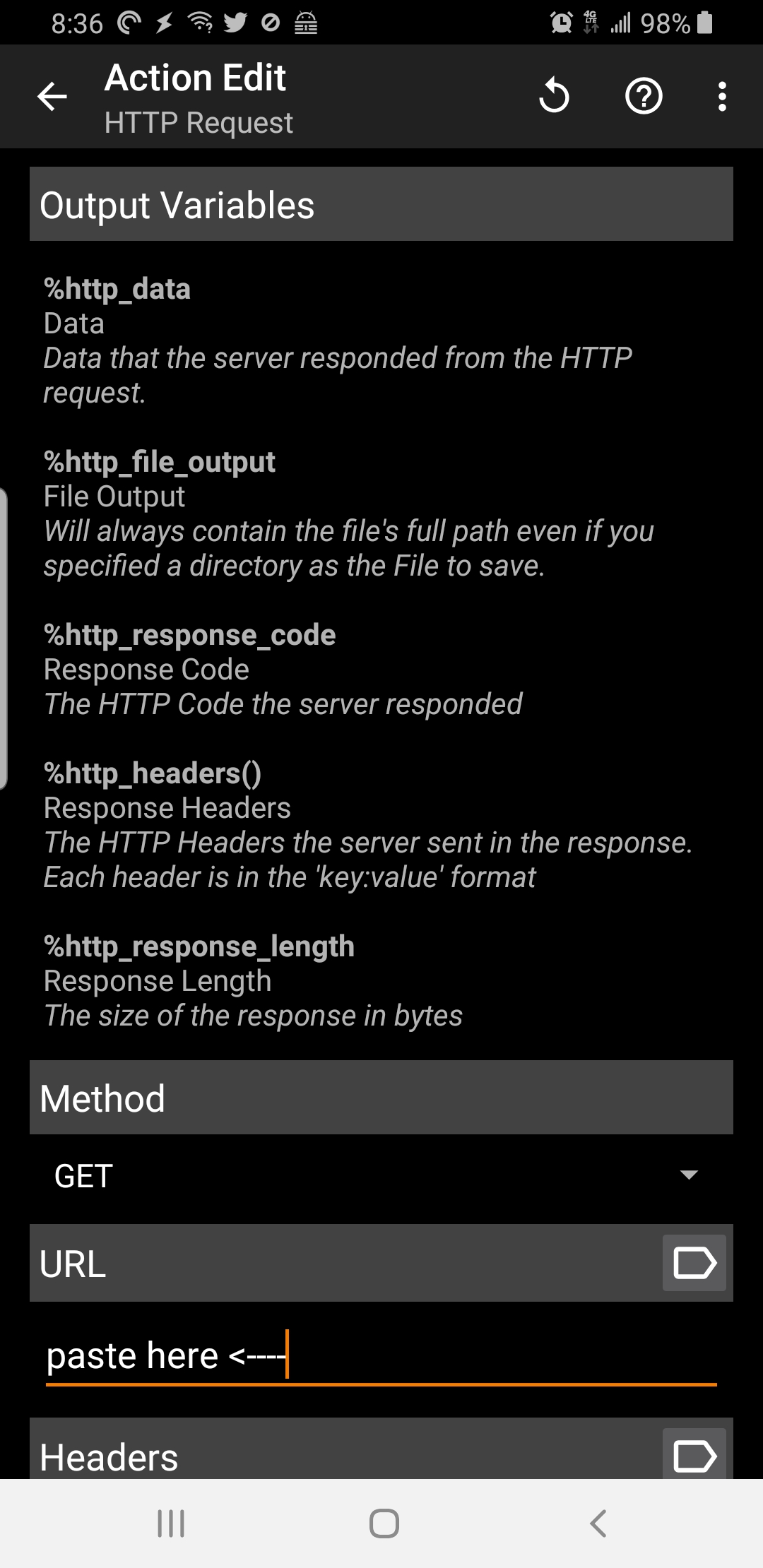

Paste it in your Tasker’s Request Task (or use Get, whichever works):
I saw that link when I click on it this is what I get I was expecting a web address
{“result”:“OK”,“timestamp”:1579877944913}

Instead of clicking the link, can you right-click the link and select “Copy link address”?
That link will need to be pasted into the URL box in Tasker’s “Action Edit” screen.
Hi, If you click the link, a new tab opens, with the message you see. You can then copy the URL from the address bar of the browser.

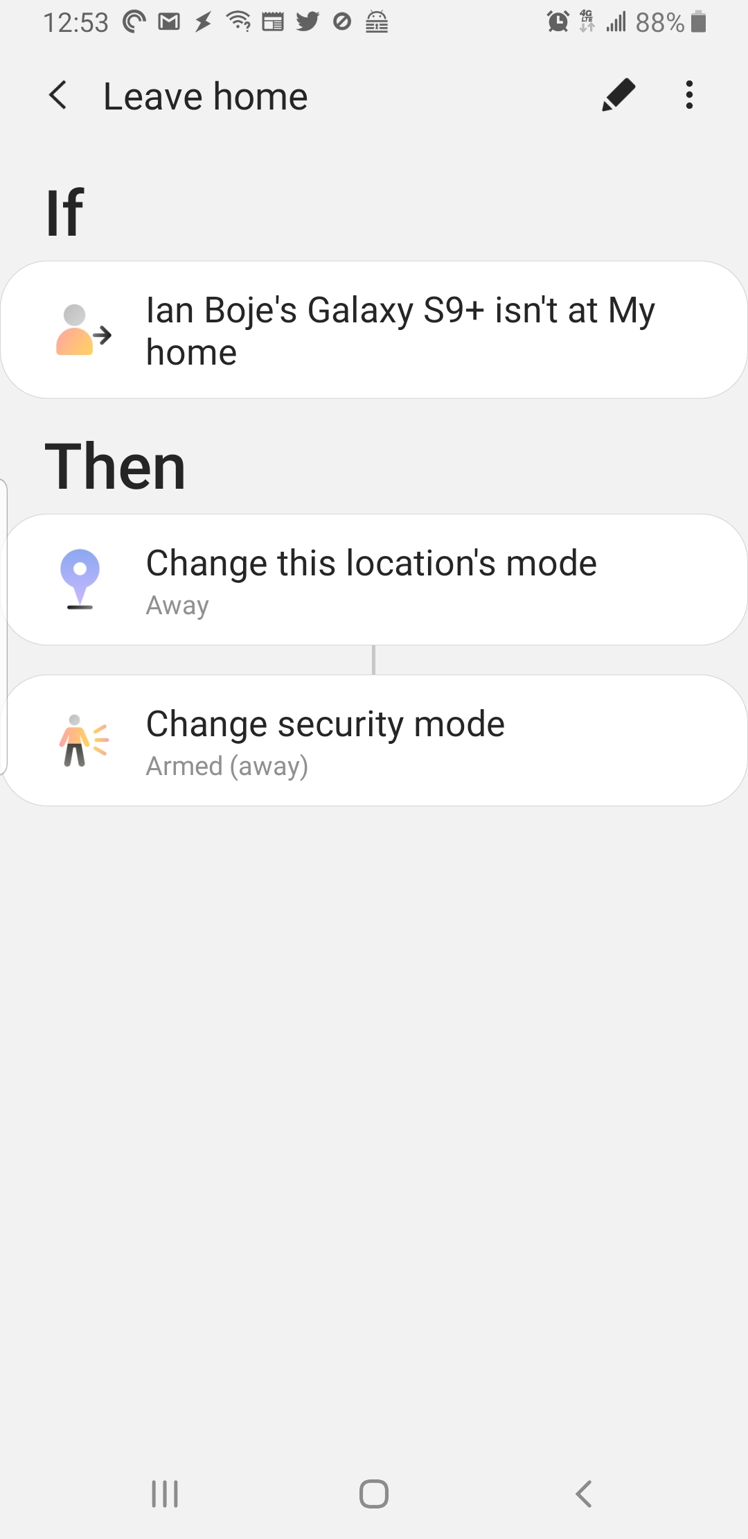

You’d probably need something to trigger the away event as well, but I’d consider using something other than wifi for that, just in case your phone has the wifi switch off or you have weak coverage in some rooms. I just use the smartthings app automation on my phone to run mine:
