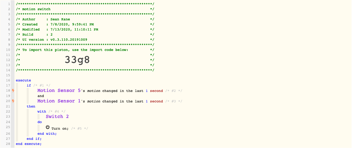

Unsure how to build. New to webCoRE.
Ideally, I would like a switch to operate if motion is detected by Motion2 only if within 30 seconds of motion triggered by Motion1.
Nothing yet. Not sure how to add the “within 30 seconds of first motion” part.

Something like this maybe
On Event from motion sensors
  If $now is after addseconds(Start,31) and
  TriggerEvent is true
         TriggerEvent = false
  If first motion is active
      Start = $now
      TriggerEvent = true
  If second motion is active and Trigger Event is true
      If $now is after addseconds(Start,30) then
            Turn on Switch
Start is a Time Variable, TriggerEvent is a Boolean.
There are probably better ways but that is what I came up with and I of coarse haven’t tested it but I think it would work. This would give you a 1 second window, which may be too tight. Every time a motion event occurs it will trigger the piston. So you may have to give it a few seconds or it might miss a trigger.
