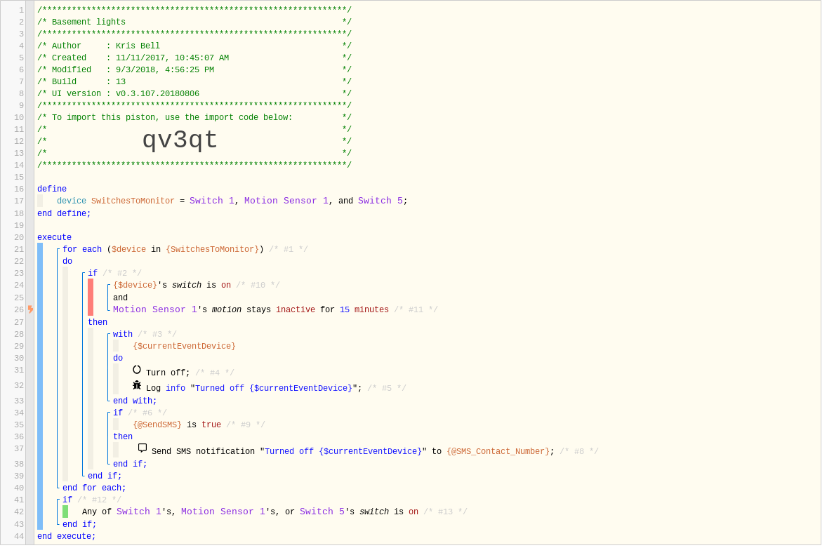

Can’t get my piston to monitor all the elements of my device variable. Motion Sensor 1 is a switch/motion sensor combined unit. For whatever reason, I can’t get the piston to monitor that device. So later in the piston when I tell it to watch the switches of the devices, it’s only watching switch 1 and 5.
I expect it to monitor the switch of the combined motion sensor/switch.
The piston only monitors the motion sensor of the combined switch
|+1ms|╔Starting piston… (v0.3.107.20180806)|
|+234ms|║╔Subscribing to devices…|
|+247ms|║║Subscribing to Basement Play Area Light.motion…|
|+305ms|║║Subscribing to Basement Landing Light…|
|+306ms|║║Subscribing to Basement TV Area Light…|
|+307ms|║╚Finished subscribing (82ms)|
|+346ms|║Comparison (enum) inactive stays (string) inactive = true (1ms)|
|+356ms|║Comparison (boolean) true is (boolean) true = true (2ms)|
|+377ms|║Comparison (enum) on is (string) on = true (2ms)|
|+384ms|╚Piston successfully started (383ms)|
