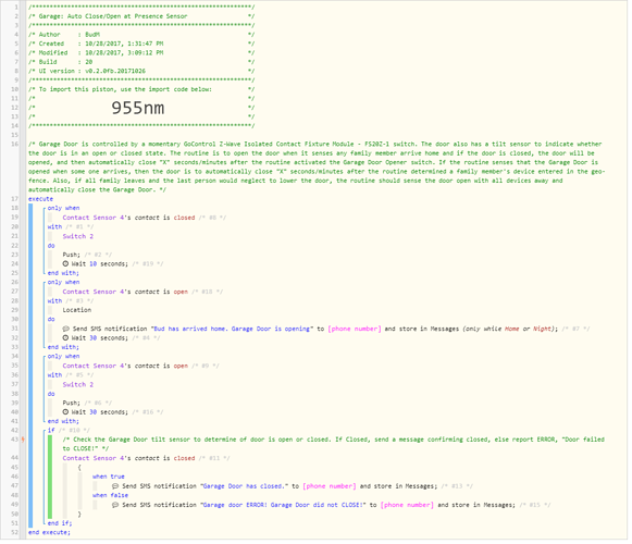

So I am a newbie to webCoRE but I have some understanding of BASIC programming and I use Crystal Report Writer on a regular basis, so I am no stranger to IF/Then routines. This is a little trickier for me. Anyway, I am just starting my fist piston and I may be a little ambitious. I first need to get the momentary switch that controls my garage door opener to work consistently. The switch is a Control Z-Wave Isolated Contact Fixture Module - FS20Z-1. I test the routine and it works but I cannot run it a second time successfully without touching the on/off button for the Garage Door Opener on my SmartThings app. It seems that I need to reset or cycle the momentary switch before the piston will execute properly. NOTE: When I push the on/off button on the iPhone SmartThings app the switch does not start the door, however a second button push will start the door. It almost seem the devise needs to be refreshed or reset to be ready to execute. Any ideas?
Consistent piston execution on subsequent runs.
Program does not execute, turn on the monetary switch after running the piston once.

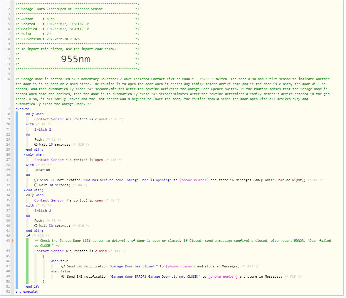

I attached the wrong image in my post, SORRY
