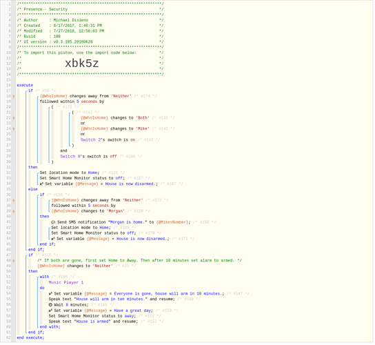

I would like to set it where if the variable changes from Neither to one of us or both that the corresponding part of the pistons will execute. Unfortunately after the followed by execution, the piston does execute the then and just goes gray. Any ideas?
The reason I want to make sure it changes away from neither is so I dont get false positives while we are home and one or the other leaves.
