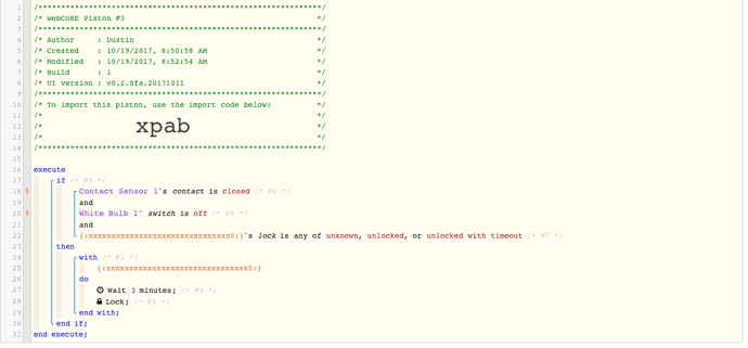

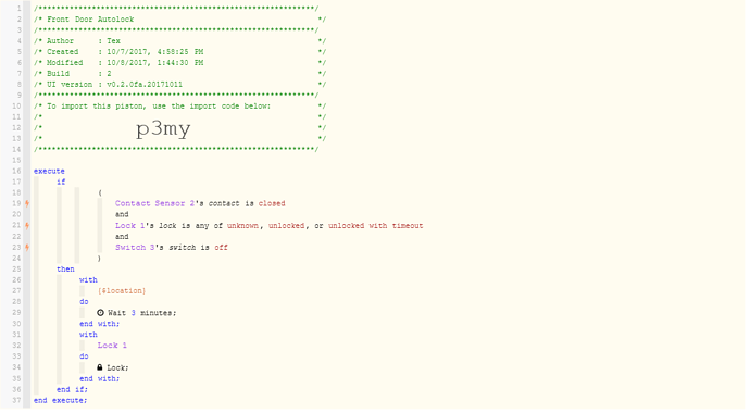

I have a Yale doorlock that I’m trying to get setup to automatically lock based on certain conditions, but it sometimes locks when the door contact is open.
I would like for the door to automatically lock if 1) The door contact is closed 2) The door is unlocked and 3) Outside switch is turned off. I want a 3 minute delay for the door to lock if those conditions are met.
Sometimes as soon as the door is opened it will lock itself even though the door contact is open.

I’ve been struggling with this piston for a long time trying to make it work correctly, but it always seems like it will lock when the door is open at random times. I have done a lot of searching and reading about similar pistons but for some reason I can’t get this to work flawlessly. Thanks for any help!
