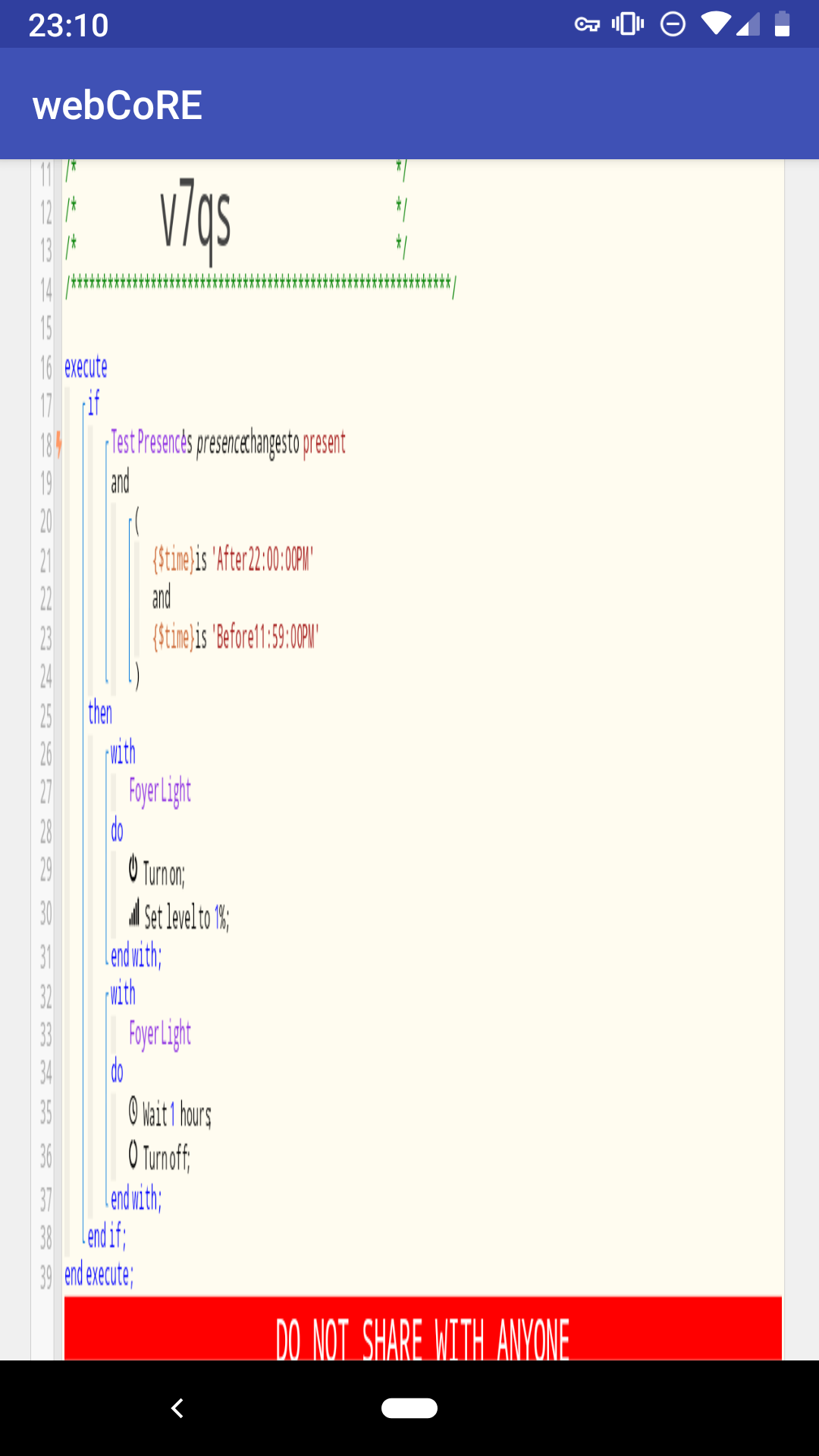

Trying to get piston to fire based on a presence sensor arriving at certain time
I’d like a the foyer light to come on for a short time on the nights I work (my nights vary so it can’t be a specific set of nights)
Tested with virtual presence sensor and light does not come on.

I am not sure if it matters, but it is a bit strange to see line 21 in military time (22:00PM) and yet line 23 is in standard time (11:59PM)
An alternative is to combine both of those lines into this instead:
IF $time24 is greater than 21
This will be true for the same time frame as you have in your code, yet it only uses one line.
… also, anything after the Wait command will never fire because the trigger will no longer be true at that time.
This can be bypassed with “Task Cancellation Policy” set to never on the block with the Wait.
Set level to 1%
I have never tried that but can you even see if the light is ON with 1%???
Yeah I have it at 1 all the time when I get home, but have to manually trigger it. It lights the area fine too get around.
I tried changing the time to $time24 and removing the end command completely and had no luck. I also tried a simple if presence sensor changes to present turn on foyer light and that worked. So I’m guessing the time thing is throwing it off for some reason
@Osufnl49
I believe it’s not working because your TIME is two IFs and with AND
on the paper it looks like it should work but my guess is that’s the cause…(I am not great with webcore’s behind the scenes part:))))

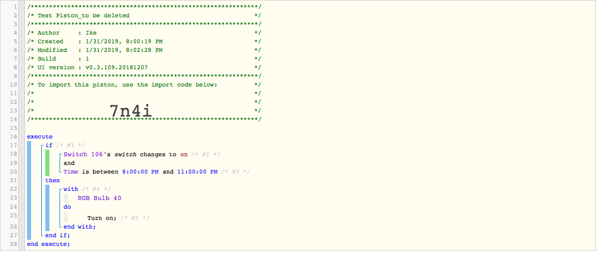

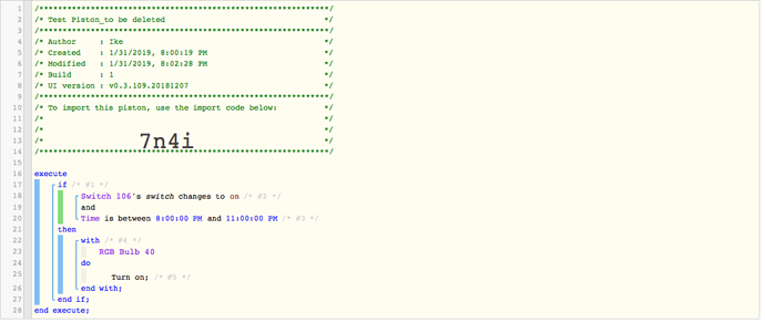

I just wrote this and it works… Download it with the code if you like…
And for the “wait” part you need to use NEVER CANCEL TASK as @WCmore mentioned.
“NEVER CANCEL TASK” How would I go about doing this?
