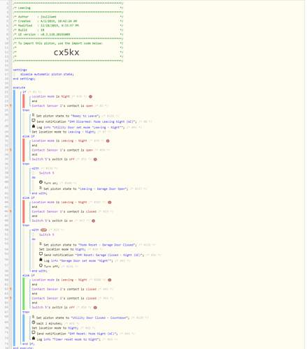

A Wait statement isn’t ever completing / the piston isn’t waking up after it. If the doors are closed (I haven’t left) and the mode is Leaving - Night, the piston is supposed to wait 2 minutes and set the mode back to night. The piston never seems to recover from the wait statement.
The piston is what I use to leave at night. I open the door into my garage, it changes the mode to Leaving - Night, which disarms SHM, and I can leave without getting any alerts. If I go into the garage for something but don’t leave, when I close the door to come back in, the piston is supposed to wait two minutes and reset the mode to night. The statement just seems to keep waiting.
The pistion isn’t moving past the wait statement on line 69.

Is that it as far as the logs are concerned? I’d expect full logs to show a ‘Setting up scheduled task …’ line, to correspond with the requested wait, and then a time event to come along when that task runs.
Yep. Door open and then door closed. Then… nothing. I wasn’t sure what was missing.
It does have something in the logs:
+309ms ║║Requesting a wake up for Thu, Nov 28 2019
That seems to show it expects to wake up, but it just doesn’t.
