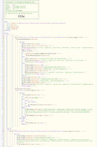

I have a piston that announces when someone is about to arrive home, and when they close the door. However, sometimes there’s more than one person in the car. I am attempting to add the additional names to the list to be spoken, but the presence change isn’t always simultaneous. This is my attempt to create a pause and look for other arrivals to add to the list.
The first arrival starts the piston. There’s a 12-pause to wait for any additional arrivals. The first and additional names are combined (and the Life360 device name removed) and then spoken.
It does not get past the initial arrival. I created SMS notifications to let me know which parts are running, and I only receive the first one.
12/17/2018, 11:55:57 PM +171ms
+1ms ╔Received event [Home].time = 1545119757521 with a delay of -350ms
+274ms ║RunTime Analysis CS > 23ms > PS > 67ms > PE > 183ms > CE
+277ms ║Runtime (54010 bytes) successfully initialized in 67ms (v0.3.109.20181207) (275ms)
+278ms ║╔Execution stage started
+280ms ║╚Execution stage complete. (1ms)
+281ms ╚Event processed successfully (281ms)
12/17/2018, 11:47:39 PM +453ms
+2ms ╔Received event [Front Door Sensor].contact = closed with a delay of 607ms
+131ms ║RunTime Analysis CS > 25ms > PS > 52ms > PE > 53ms > CE
+134ms ║Runtime (53983 bytes) successfully initialized in 52ms (v0.3.109.20181207) (130ms)
+135ms ║╔Execution stage started
+150ms ║║Comparison (enum) closed changes_to (string) closed = true (1ms)
+152ms ║║Cancelling condition #156’s schedules…
+155ms ║║Cancelling statement #160’s schedules…
+160ms ║║Executed virtual command setVariable (1ms)
+170ms ║║Comparison (dynamic) Life360 Derek is (string) Google = false (2ms)
+172ms ║║Condition #163 evaluated false (8ms)
+173ms ║║Condition group #162 evaluated false (state did not change) (9ms)
+177ms ║║Cancelling statement #166’s schedules…
+190ms ║║Calculating (string) Well, Welcome Home + (string) Life360 Derek >> (string) Well, Welcome Home Life360 Derek
+194ms ║║Calculating (string) Well, Welcome Home Life360 Derek + (string) , did you bring any food home? >> (string) Well, Welcome Home Life360 Derek, did you bring any food home?
+198ms ║║Executed virtual command setVariable (1ms)
+204ms ║║Executed virtual command setVariable (1ms)
+206ms ║║Condition #156 evaluated true (60ms)
+207ms ║║Cancelling statement #155’s schedules…
+208ms ║║Condition group #155 made progress up the ladder, currently at step 2 of 2
+210ms ║║Cancelling statement #155’s schedules…
+211ms ║║Condition group #155 evaluated true (state did not change) (70ms)
+212ms ║║Cancelling condition #101’s schedules…
+213ms ║║Condition group #101 evaluated true (state changed) (73ms)
+239ms ║║Condition #110 evaluated false (21ms)
+240ms ║║Condition group #109 evaluated false (state did not change) (24ms)
+243ms ║╚Execution stage complete. (109ms)
+244ms ╚Event processed successfully (244ms)
12/17/2018, 11:47:28 PM +815ms
+2ms ╔Received event [Front Door Sensor].contact = open with a delay of 640ms
+145ms ║RunTime Analysis CS > 27ms > PS > 63ms > PE > 54ms > CE
+148ms ║Runtime (54025 bytes) successfully initialized in 63ms (v0.3.109.20181207) (144ms)
+161ms ║║Comparison (enum) open changes_to (string) closed = false (1ms)
+166ms ║║Condition group #169 evaluated true (state did not change) (0ms)
+169ms ║║Cancelling statement #170’s schedules…
+174ms ║║Executed virtual command setVariable (1ms)
+177ms ║║Condition #156 evaluated false (20ms)
+178ms ║║Cancelling condition #101’s schedules…
+180ms ║║Condition group #101 evaluated false (state changed) (25ms)
+209ms ║║Condition #110 evaluated false (26ms)
+211ms ║║Condition group #109 evaluated false (state did not change) (27ms)
+214ms ║╚Execution stage complete. (65ms)
+215ms ║Setting up scheduled job for Mon, Dec 17 2018 @ 11:55:57 PM PST (in 508.491s)
+225ms ╚Event processed successfully (224ms)
12/17/2018, 11:46:09 PM +169ms
+1ms ╔Received event [Home].time = 1545119169513 with a delay of -344ms
+185ms ║RunTime Analysis CS > 47ms > PS > 82ms > PE > 56ms > CE
+189ms ║Runtime (54021 bytes) successfully initialized in 82ms (v0.3.109.20181207) (187ms)
+190ms ║╔Execution stage started
+199ms ║║Cancelling condition #155’s schedules…
+201ms ║║Cancelling condition #101’s schedules…
+212ms ║╚Execution stage complete. (22ms)
+214ms ║Setting up scheduled job for Mon, Dec 17 2018 @ 11:55:57 PM PST (in 588.139s)
+222ms ╚Event processed successfully (222ms)
12/17/2018, 11:45:58 PM +128ms
+2ms ╔Received event [Life360 Eric].presence = present with a delay of 146ms
+157ms ║RunTime Analysis CS > 28ms > PS > 67ms > PE > 62ms > CE
+161ms ║Runtime (54030 bytes) successfully initialized in 67ms (v0.3.109.20181207) (157ms)
+162ms ║╔Execution stage started
+179ms ║║Cancelling condition #156’s schedules…
+183ms ║║Condition group #169 evaluated true (state did not change) (0ms)
+186ms ║║Cancelling statement #170’s schedules…
+191ms ║║Executed virtual command setVariable (2ms)
+194ms ║║Condition #156 evaluated false (23ms)
+195ms ║║Condition group #101 evaluated false (state did not change) (28ms)
+219ms ║║Comparison (enum) present changes_to (string) not present = false (0ms)
+221ms ║║Condition #110 evaluated false (23ms)
+223ms ║║Condition group #109 evaluated false (state did not change) (24ms)
+226ms ║╚Execution stage complete. (65ms)
+229ms ║Setting up scheduled job for Mon, Dec 17 2018 @ 11:46:09 PM PST (in 11.157s), with 1 more job pending
+241ms ╚Event processed successfully (241ms)
12/17/2018, 11:45:57 PM +282ms
+2ms ╔Received event [Life360 Derek].presence = present with a delay of 118ms
+123ms ║RunTime Analysis CS > 19ms > PS > 54ms > PE > 49ms > CE
+126ms ║Runtime (53985 bytes) successfully initialized in 54ms (v0.3.109.20181207) (123ms)
+127ms ║╔Execution stage started
+154ms ║║Comparison (enum) present changes_to (string) present = true (1ms)
+160ms ║║Cancelling condition #102’s schedules…
+163ms ║║Cancelling statement #173’s schedules…
+168ms ║║Executed virtual command setVariable (2ms)
+175ms ║║Executed virtual command setVariable (4ms)
+189ms ║║Calculating (string) 1 Arrival = + (string) Yes >> (string) 1 Arrival = Yes
+194ms ║║Calculating (string) 1 Arrival = Yes + (string) , Who Arrived = >> (string) 1 Arrival = Yes, Who Arrived =
+199ms ║║Calculating (string) 1 Arrival = Yes, Who Arrived = + (string) Life360 Derek >> (string) 1 Arrival = Yes, Who Arrived = Life360 Derek
+203ms ║║Calculating (string) 1 Arrival = Yes, Who Arrived = Life360 Derek + (string) , Who All Arrived = >> (string) 1 Arrival = Yes, Who Arrived = Life360 Derek, Who All Arrived =
+207ms ║║Calculating (string) 1 Arrival = Yes, Who Arrived = Life360 Derek, Who All Arrived = + (string) Life360 Derek >> (string) 1 Arrival = Yes, Who Arrived = Life360 Derek, Who All Arrived = Life360 Derek
+224ms ║║Executed virtual command sendSMSNotification (11ms)
+229ms ║║Executed virtual command wait (0ms)
+230ms ║║Requesting a wake up for Mon, Dec 17 2018 @ 11:46:09 PM PST (in 12.0s)
+234ms ║║Condition #102 evaluated true (100ms)
+236ms ║║Cancelling statement #155’s schedules…
+237ms ║║Condition group #155 made progress up the ladder, currently at step 1 of 2
+241ms ║║Condition group #101 evaluated false (state did not change) (109ms)
+260ms ║║Comparison (enum) present changes_to (string) not present = false (1ms)
+263ms ║║Condition #110 evaluated false (18ms)
+264ms ║║Condition group #109 evaluated false (state did not change) (20ms)
+267ms ║╚Execution stage complete. (141ms)
+269ms ║Setting up scheduled job for Mon, Dec 17 2018 @ 11:46:09 PM PST (in 11.963s), with 1 more job pending
+278ms ╚Event processed successfully (277ms)
