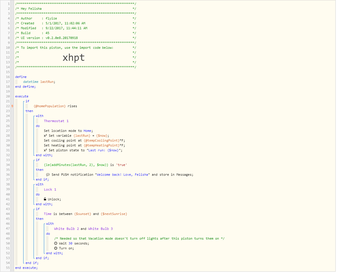

Trying to compare two times. Is this correct?
I want part of a piston to only run if it hasn’t run in the last two minutes
I get a notification
I’m not getting a notification
As you can see, the expression I’m using is:
le(addMinutes(lastRun, 2), $now)
but apparently that’s wrong. What am I missing?
virtual device -> Date & Time is greater than the left hand expression
though, since you set lastRun to now immediately before this comparison this if condition will always be true.
I’m not sure I understood your first sentence. However, DUH, setting lastRun right before the comparison was a silly mistake.
sorry … change the if statement to use this condition if le(…) is not working
if virtual device -> Date & Time is greater than addMinutes(…)
