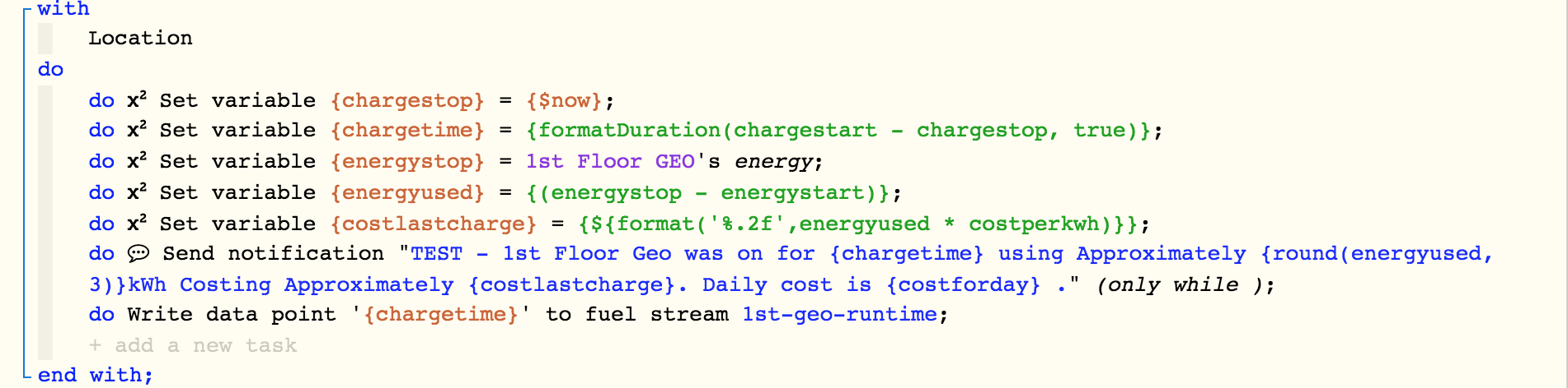

I am trying to post the runtime intervals of my geo thermal unit to fuel stream. But when i check out the fuel stream I get the error, " Data Column for axes #0 cannot be of type string ". So I awesome my problem is that my variable that keeps the runtime is set to dynamic and not an integer. How can I convert my run time from minutes/seconds to an integer ?
What should I convert my dynamic variable that contains the runtime to something stream fuel can understand ?
