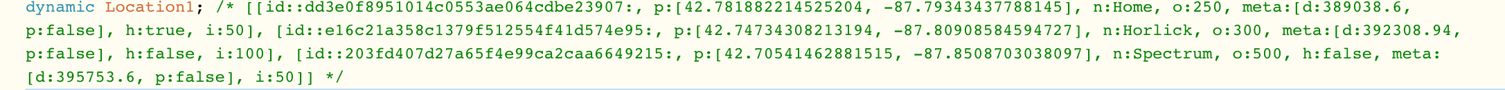

I have this variable set up. Not sure if type is correct. However, these are locations from my piston for $places. Is there an expression I can use to index through them and pull out what I need for each location.
Something like {test}.[$index].n.
I’m just not sure how to Setup that expression. Any help would be appreciated.
Here is my current variable as is
Try adding parse json on that variable. Then output $json to the console and see what it returns. I have a feeling it might not work since the data isn’t in double quotes.
