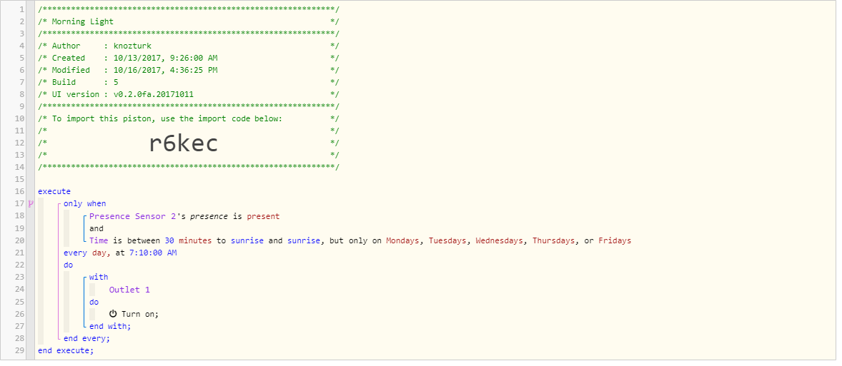

I am trying to turn on my bedroom lights in the morning at 7:10 AM if there is 30 min to sunrise but it is not working at all
It is not triggering at all

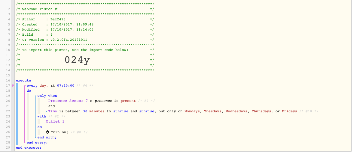

Try this. Run the test after importing it so it sets up the first action at the scheduled time.
