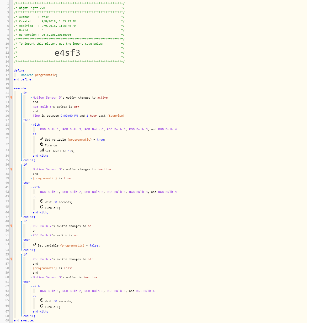

Lights will not turn off after variable is set to false
Hallway lights after motion is no longer detected should turn off, unless the lights in the other room have been turned on. After the lights in the other room are turned off, it should resume turning off the lights in the hallway after motion is no longer detected.
If the nursery action is triggered, the hallway lights won’t turn off, even if room lights have been turned off.!
