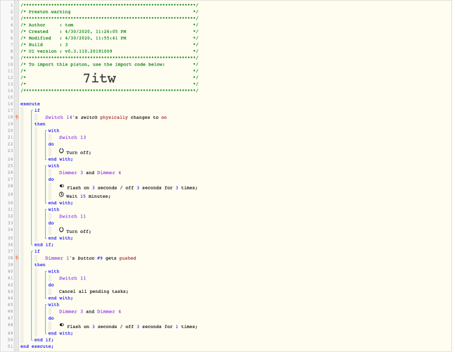

virtual switch wont reset
I’d like to execute a google home routine that turn a virtual switch on that triggers this piston. The piston should blink my kids lights, wait x seconds, and then turn his outlet off. If I press the up button a few times on a different switch, it should cancel the “xbox shutdown sequence” :slight_smile:
When i turn the virtual switch on, it stays on, and is not ready for me to execute the command at a later time. Im thinking the switch needs to be automatically set to off. I thought a momentary push button would work better, but i can seem to link a google home routine to a momentary push button.

I’m assuming Dimmer 1’s button #9 is the virtual switch that the google routine turns on? Whichever it is, you need to add something to your piston to turn the virtual switch off when you are done processing the request. I would suggest at the end of the first If block in your piston.

For anyone that is interested, I got it working. I created a google assistant routine that sends a broadcast throughout the house letting my kids know its time to do their chores and turn on a virtual switch. The virtual switch triggers this piston that blinks their lights a few times giving them a 15 minute warning. If they dont come find me and let me know they are starting their chores, their outlet will be turned off. If they do find me and let me know they started their chores. I’ll press the up button on one of my switches 4 times. This will cancel the 15 minute timer and blink a nearby light one time. the purpose of the blink is to verify i clicked the button 4 times. Heres a copy of the piston. Enjoy!
Just so you know, the way piston “7itw” is worded, you can also cancel turning off Switch 11 (Xbox) by turning off Switch 14.
