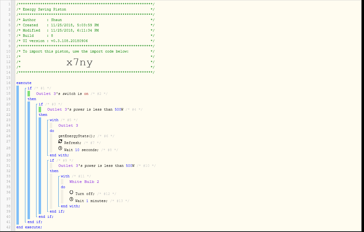

Turn off device if consumption is less then X for X mintues
I want to create a piston that turns off devices that have been left on. For example, turn off my PC if consumption is less then 500watts for 1 minute.
The piston i have made just seems to loop itself refreshing the power stats.

Try STAYS LESS THAN for 1 minute… (I believe it is stays less than)
It should be trigger not condition…
IS is a condition and as long as the condition remains TRUE, it will loop.
Sorry writing this without testing it… Not in front of my computer.
