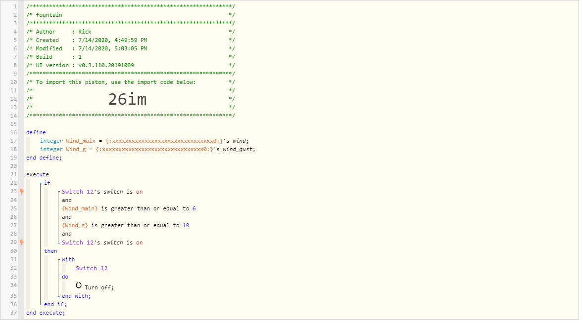

I have a switch on a fountain but when its windy the water blows all over so I would like to shut it off if its windy.
I have only a couple basic pistons
I found this one in the forum but not sure how to define the integer when I used the backup code it wanted a temp sensor.
Thanks
Turn off Fountain when windy

Do you not have to difine a variable for the windspeed and windgust first
I have this but it does not look right
I am not sure if “Refresh” does what you want it to, but ignoring that for a moment, here is a slight modification on your last piston. This one will prevent spam to the weather server unless the fountain is actually turned on.
Well, that’s 2 of us. I don’t know what the refresh does either
I removed and added a time for the fountain to come on and off
It is your house, but I would highly encourage you to add a spam-block.
For example, your fountain is only on for < 4 hours a day, yet your current code pulls wind data all day every day. (144 times a day) For comparison, with my small tweak below, it only pulls data at the relevant times. (23 times a day, or 626% more efficient)
Essentially, it prevents useless queries unless the fountain is actually on.
(this is courteous, since SmartThings is billed for each TWC query you make)
TL;DR
If we abuse TWC, then I suspect SmartThings will start charging us for that data.
I took a few minutes to create this for you.
Note: Even if you manually turn on the fountain, the wind will still be checked properly.
