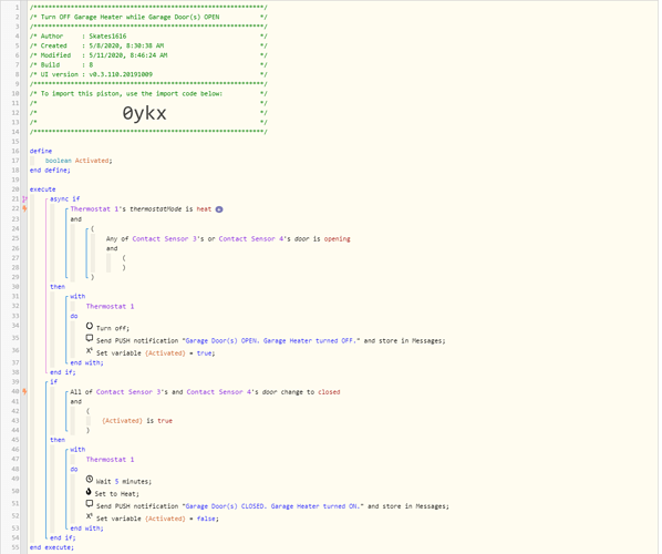

Turn off Garage Heater based on Garage Door OPEN/CLOSED
At the end of the Piston, when the garage door closes, the mode is to return back to HEAT. It does return, but then immediately after the mode if changed back to OFF.
The garage heater mode should be OFF when the Garage Door(s) are OPEN and HEAT when all Garage Door(s) are closed.
The mode if changed to OFF after it is changed to HEAT.

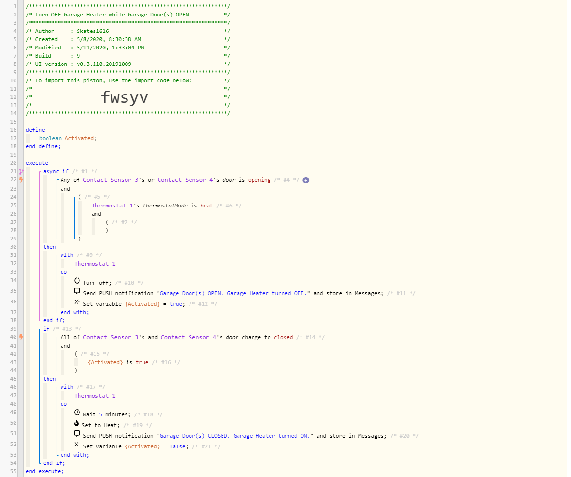

   5/11/2020, 12:52:06 PM +972ms
+2ms	╔Received event [Garage Thermostat].thermostatMode = off with a delay of 76ms
+9309ms	║RunTime Analysis CS > 19ms > PS > 9266ms > PE > 24ms > CE
+9310ms	║Piston waited at a semaphore for 9262ms
+9312ms	║Runtime (40670 bytes) successfully initialized in 9266ms (v0.3.110.20191009) (9310ms)
+9313ms	║╔Execution stage started
+9320ms	║║Comparison (enum) off is (string) heat = false (1ms)
+9321ms	║║Cancelling condition #4's schedules...
+9322ms	║║Condition #4 evaluated false (5ms)
+9323ms	║║Cancelling condition #1's schedules...
+9324ms	║║Condition group #1 evaluated false (state changed) (8ms)
+9336ms	║║Condition #14 evaluated false (9ms)
+9336ms	║║Condition group #13 evaluated false (state did not change) (10ms)
+9338ms	║╚Execution stage complete. (25ms)
+9339ms	╚Event processed successfully (9339ms)
5/11/2020, 12:52:05 PM +994ms
+1ms	╔Received event [Garage Thermostat].thermostatMode = heat with a delay of 49ms
+46ms	║RunTime Analysis CS > 18ms > PS > 5ms > PE > 23ms > CE
+48ms	║Runtime (40595 bytes) successfully initialized in 5ms (v0.3.110.20191009) (46ms)
+49ms	║╔Execution stage started
+56ms	║║Comparison (enum) heat is (string) heat = true (1ms)
+57ms	║║Cancelling condition #4's schedules...
+58ms	║║Condition #4 evaluated true (5ms)
+71ms	║║Comparison (enum) opening is (string) opening = true (2ms)
+72ms	║║Condition #6 evaluated true (13ms)
+74ms	║║Condition group #7 evaluated true (state did not change) (1ms)
+75ms	║║Condition group #5 evaluated true (state did not change) (15ms)
+76ms	║║Cancelling condition #1's schedules...
+76ms	║║Condition group #1 evaluated true (state changed) (24ms)
+78ms	║║Cancelling statement #9's schedules...
+1134ms	║║Executed physical command [Garage Thermostat].off() (1052ms)
+1135ms	║║Executed [Garage Thermostat].off (1054ms)
+1154ms	║║Executed virtual command [Garage Thermostat].sendPushNotification (16ms)
+1159ms	║║Executed virtual command [Garage Thermostat].setVariable (2ms)
+1169ms	║║Condition #14 evaluated false (7ms)
+1170ms	║║Condition group #13 evaluated false (state did not change) (8ms)
+1172ms	║╚Execution stage complete. (1124ms)
+1173ms	╚Event processed successfully (1173ms)

I would strongly recommend avoiding this logic:
IF Thermostat's mode changes       (line 22)
    Then do stuff
END IF
IF Something happens
    Then change Thermostat's mode  (line 50)
END IF
Every time line 50 executes, the piston will start all over from the top.
A typical solution would be to remove the forced subscription on line 22, so the ‘mode’ is treated as a condition.
IE, the first block can be:
IF Any Door changes to open    <-- Trigger
    IF thermostatMode is heat  <-- Condition
        Do stuff
    END IF
END IF
Good catch, made the change…
