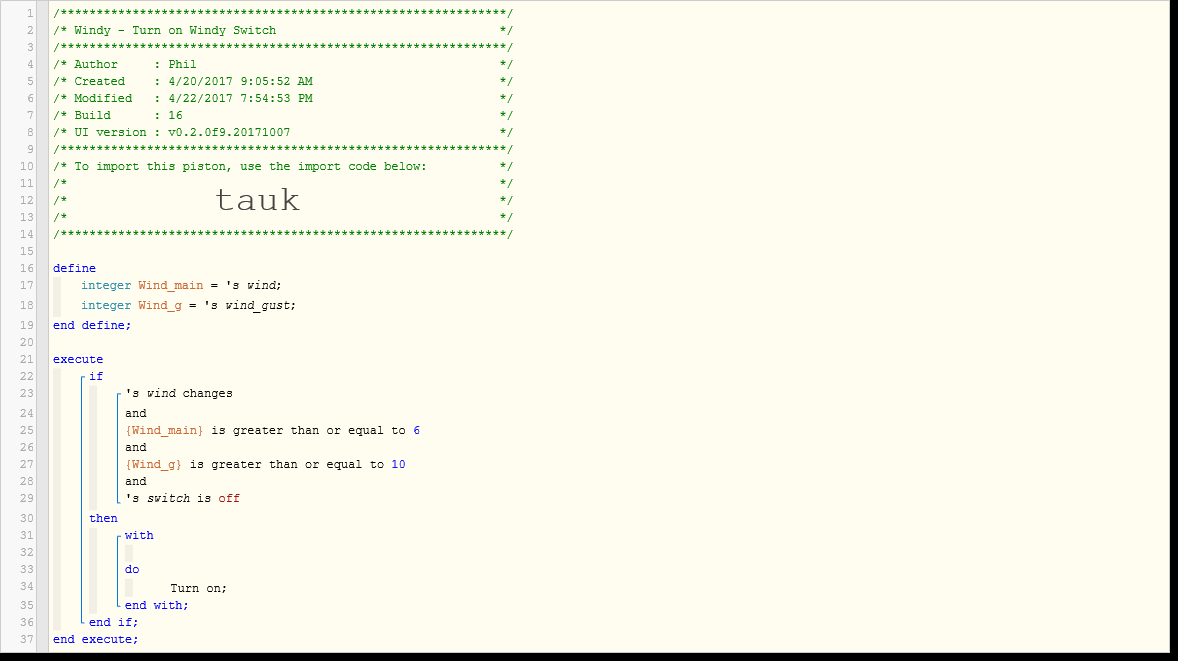

Here is one that I use for my motion lights and motion outside. Windy Switch is a virtual switch that I use in many pistons

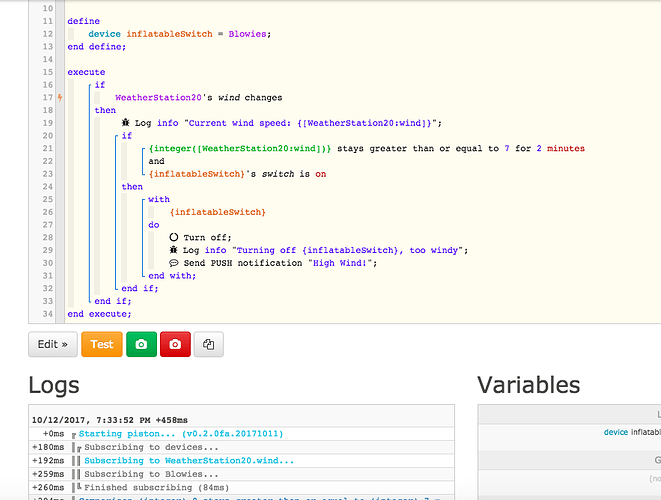

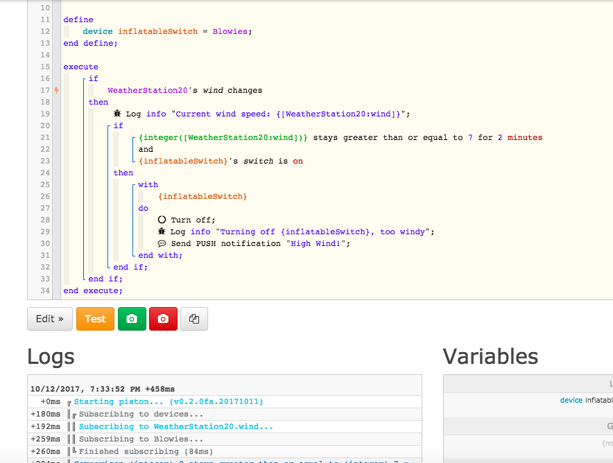

Thanks for all the great replies! Should I see logging daily from my piston doing the checking? I have the log set to FULL but only see logs if I run a test but it says the piston is runningā¦

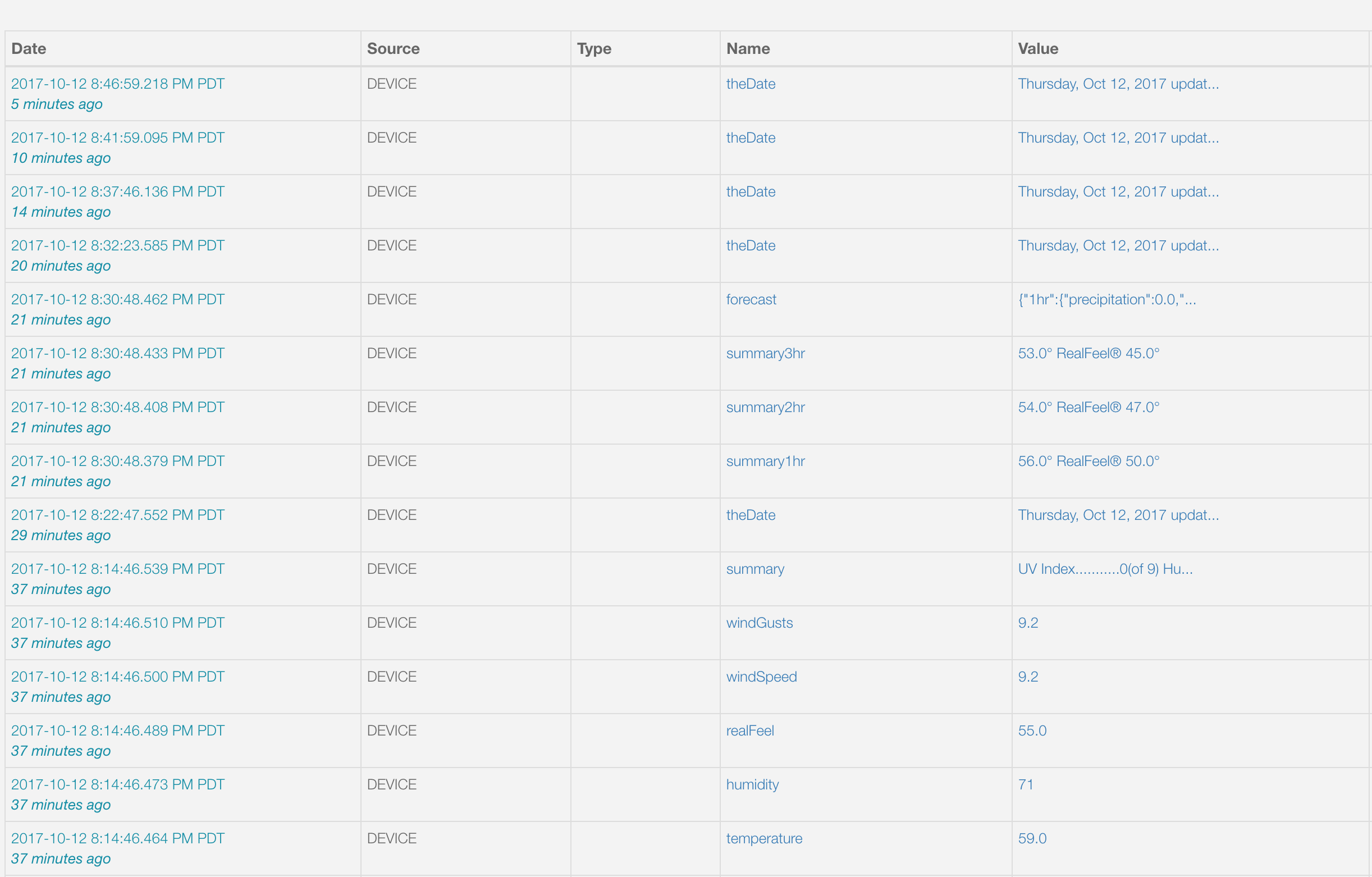

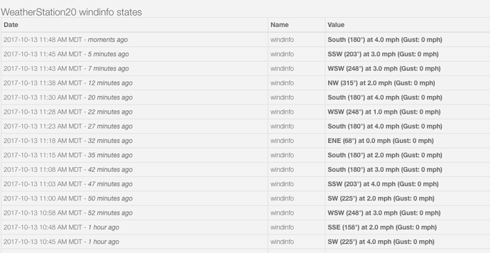

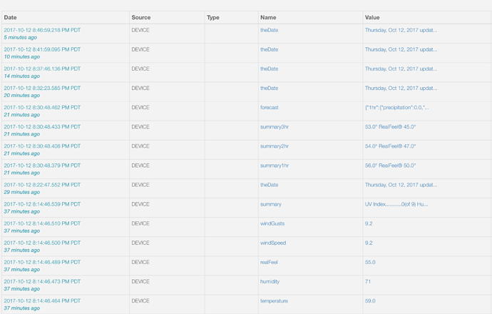

this is from accuweather and the next one is from smartweather tile 2.0. both seem to publish wind events so wC should be receiving them as well.
So I see it updating on the smartthings side but I am not seeing it log in WebCoRE, what could i be doing wrong?
I just thought per the webcore code it should be updating the webcore piston log everytime wind changes but the log is still sitting at 7:33pm from last night when I manually did itā¦
