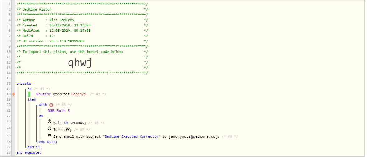

I’m trying to turn off a light 10 seconds after a routine executes
The kitchen light turns off 10 seconds after Goodbye routine is run
Webcore sees the routines firing and then fails with an error code
12/05/2020, 09:25:41 +581ms
+0ms ╔Received event [My home].routineExecuted = 74a61ba7-778e-4cb1-bfd7-31b7b19a6660 with a delay of 32ms
+84ms ║RunTime Analysis CS > 13ms > PS > 42ms > PE > 28ms > CE
+86ms ║Runtime (37401 bytes) successfully initialized in 42ms (v0.3.110.20191009) (85ms)
+87ms ║╔Execution stage started
+96ms ║║Comparison (string) :da1070ab0c5a2a143a5787e238fd5972: executes (string) :da1070ab0c5a2a143a5787e238fd5972: = true (2ms)
+98ms ║║Condition #2 evaluated true (6ms)
+99ms ║║Condition group #1 evaluated true (state did not change) (7ms)
+102ms ║║Cancelling statement #5’s schedules…
+174ms ║║An error occurred while executing the event: java.lang.NullPointerException: Cannot invoke method hasCommand() on null object
+176ms ║╚Execution stage complete. (89ms)
+177ms ╚Event processed successfully (177ms)Preformatted text
